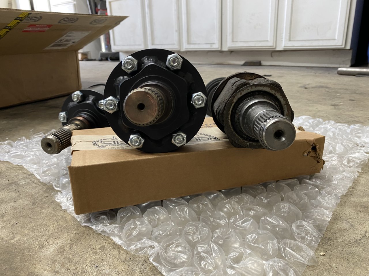

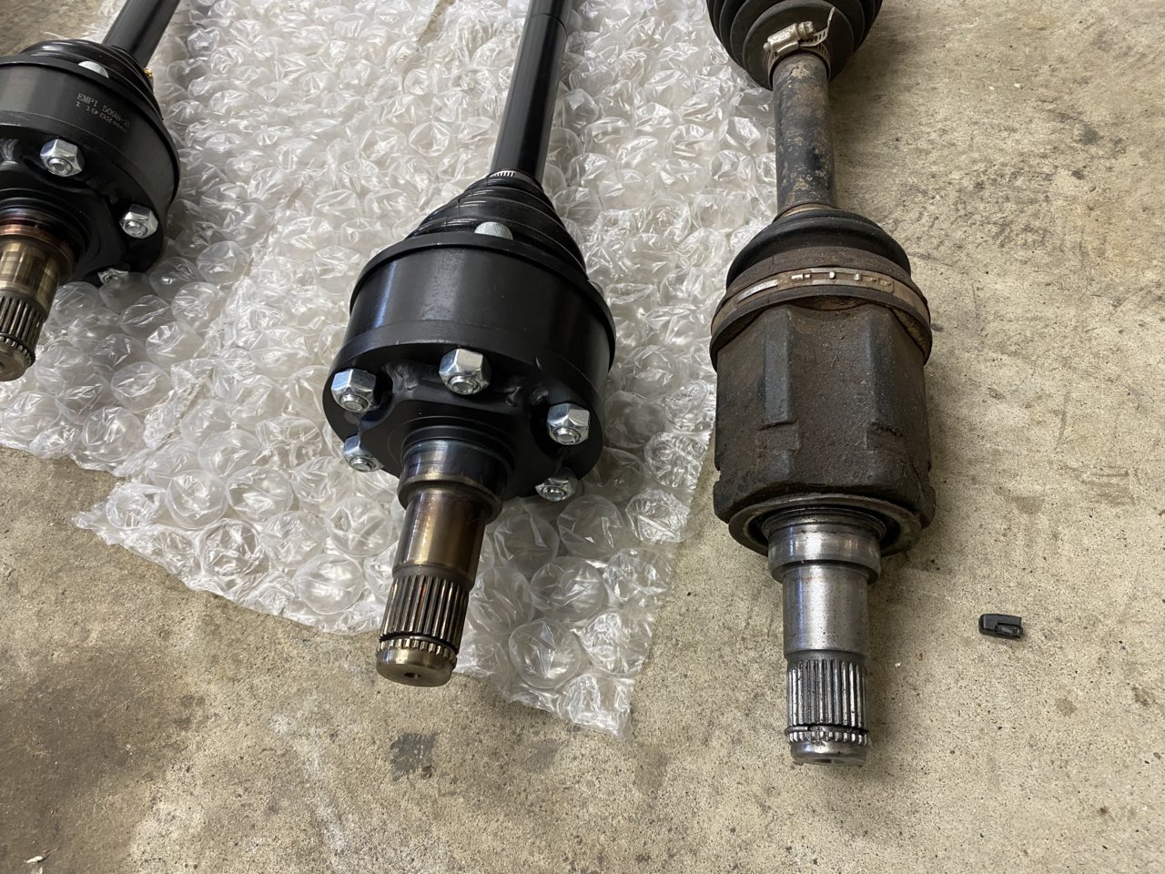

    Some pieces of my LT puzzle arrived today. More coming tomorrow.

    2.25" or 4"? Those axles look really nice. Congrats on making the jump.
    EatSleepTacos[QUOTED] likes this.
  10. Mar 29, 2021 at 4:24 PM
    EatSleepTacos
    Mar 24, 2015
    #151688
    59,841
    Randy
    West Valley, AZ
    2017 4Runner
    2.25, and thank you. I’m incredibly excited and also incredibly sad I have to wait another 3 months for coilovers

    Who made the CV's? 930 or 934?

    I just did another set this weekend. I use an angle grinder with a cut off wheel. Takes about 45seconds to cut them off. I’m usually about 3/8”-1/2” above the star, but still low enough to rotate the star and remove. The first set had to be lathed out to remove the clip, this set I used a very lite touch of heat and smacked it with a brass hammer. Got them to separate nicely.

    So much for a brass fucking hammer lmao
    I’m 0/2 with axles right now.

    You aint lyin. I was going to give it some good whacks first and then carefully cut it apart and take it to the local machine shop if it didn't work, but noooo. This only took like 7-8 hits to break the cage.
