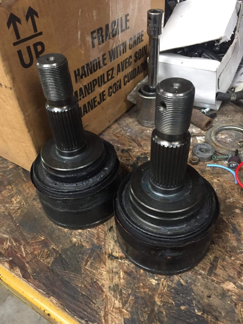

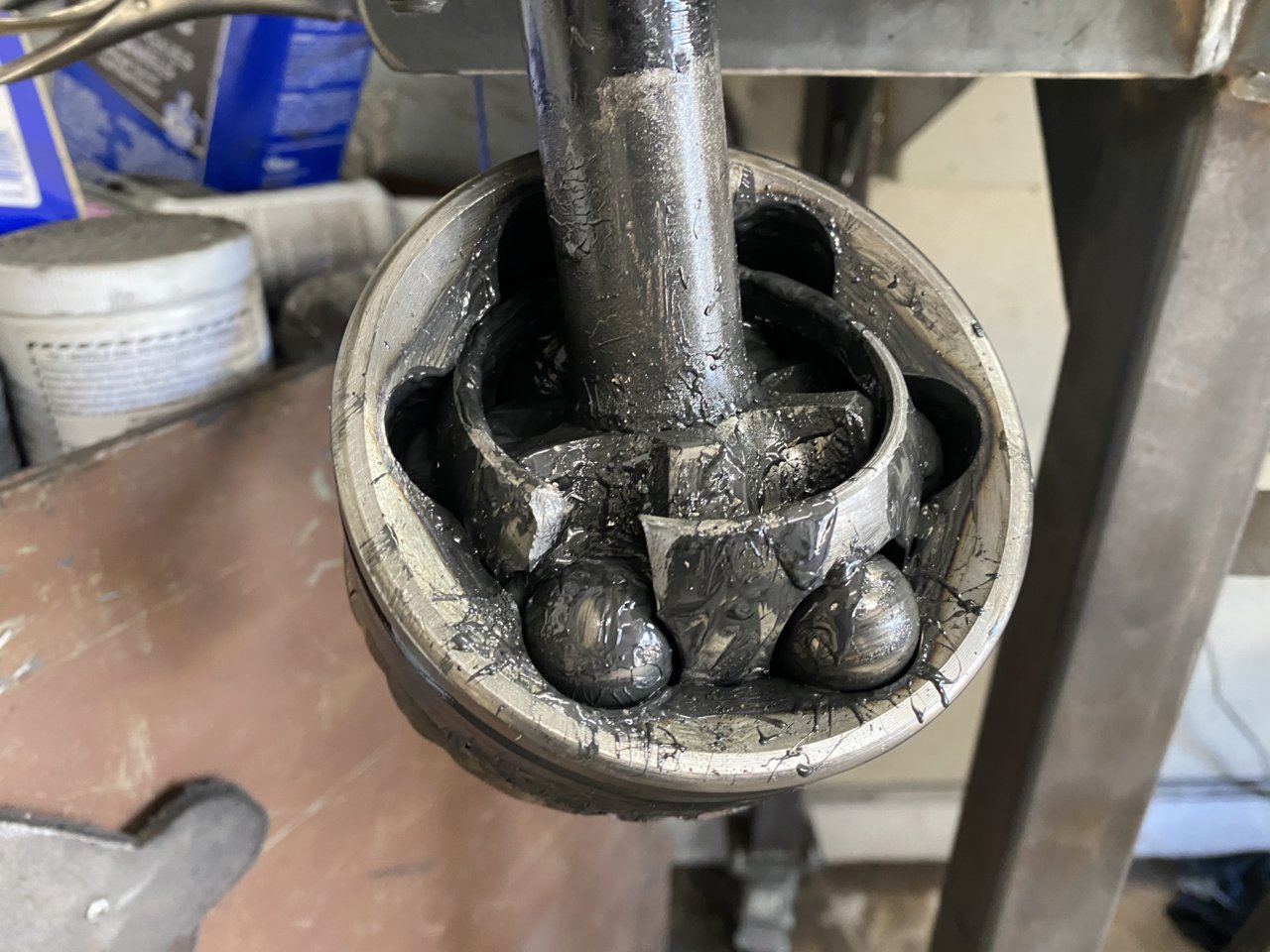

    Going back to the earlier talk about the right tool for cutting the shaft, I’ll admit I was wrong. I decided to practice on this one since it was already trash and it really wasn’t that difficult to cut close enough with an angle grinder. I just rotated the axle around and cut a bit on each side. Worked great. I guess my issue with the first one was that I didn't cut the stub close enough which is what made it a PITA.

    Talk about a turn of events for luck. Found a dude with a pair of oem outers already separated from the axles because he went to manual hubs. $100 for the pair and I don’t need to muck around with separating them at all.

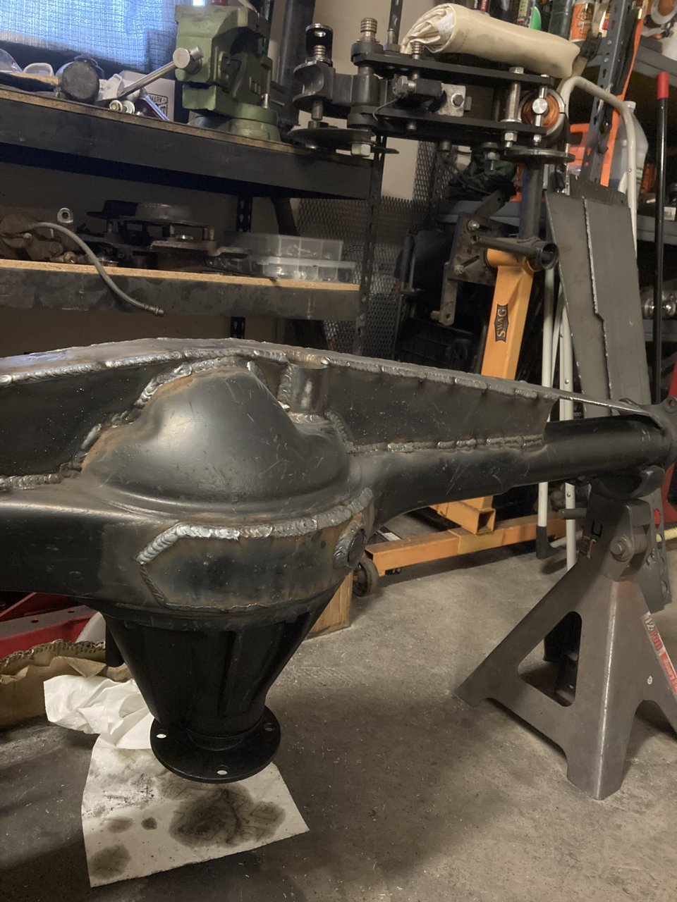

    Truss coming together on the Tundra axle.

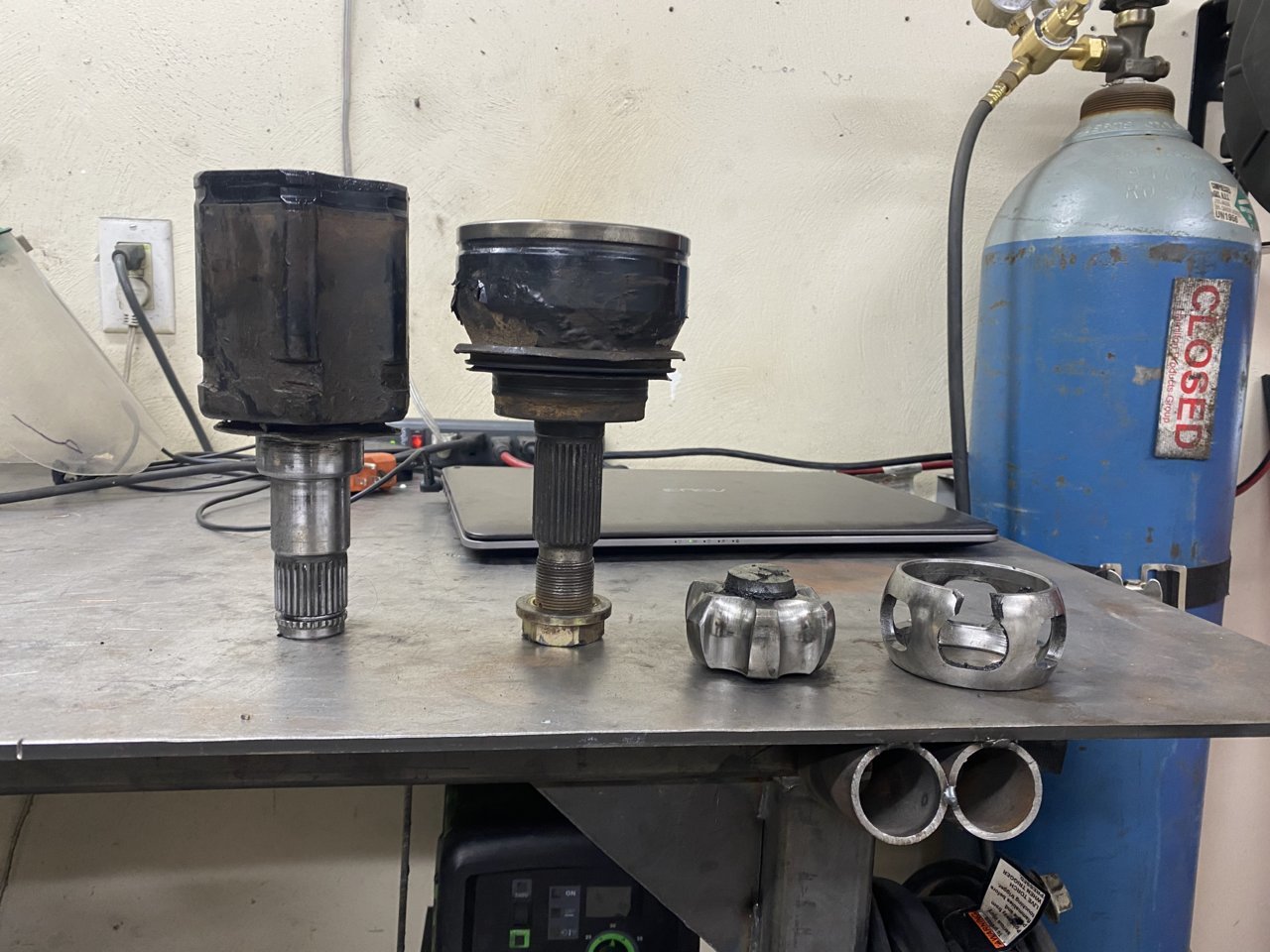

    When putting the outer CV joints onto the LT axle shafts, what's a tried a true method? I was thinking of getting it started on the splines, threading an axle nut on so I don't booger the threads, and then whacking it with a hammer to pop it on. I'm curious to hear what has worked for others

    I just did what you just said with a pretty big dead blow. It goes on way easier then off lol.

    After ensuring that the snap ring is inside the star, I pick it up and drop it on the concrete to seat the snap ring. I also try and tug on it to make sure its in.

    So you put the ring in the star vs on the shaft? Any particular reason?

    No, I install the snap ring on the axle first but when I start the axle into the star, I make sure the ring goes in smoothly. I have sheared off a snap ring because it was slightly out of shape and I didn't pay enough attention to the snap ring starting into the start. I usually pre-grease the joint, so it can be hard to see the snap ring start into the star.

    Yeah you gotta make sure the new snap ring is centered when it starts in the star. Took me a minute to figure out why I couldn’t get the shaft to start into the splines the first time I built an axle. Luckily I had a spare snap ring since I jacked the first one up.

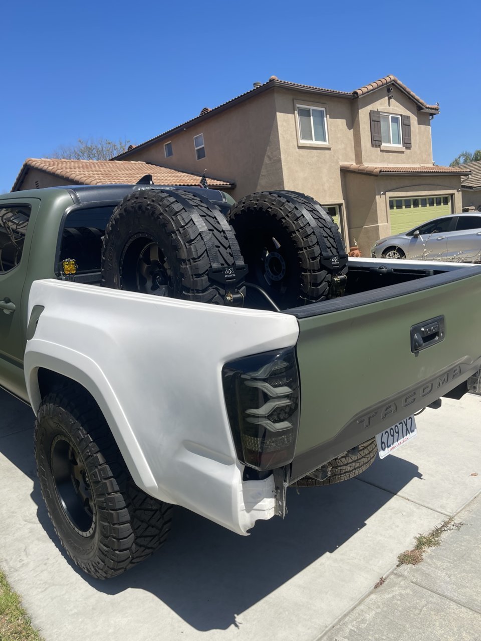

    is that an off the shelf rack or did the guy making your bumper build it. Looks good.

    I guess you can say its an off the shelf, I bought it from SDHQ Motorsports !
