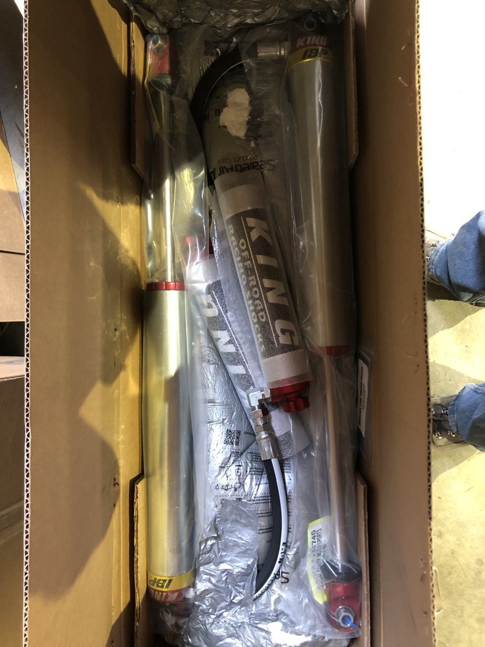

    One step closer to having my dream set up! Just need to order the LT kit and get the coils powder coated

    I'd caution you on PCing the coils. I've seen more than one instance where the outcome is undesired. Just a heads up.

    Going TC for the Front. Not doing a LT kit for the rear but I’m going with BAMF shock relocation and Deaver U402.
    Thanks for the heads up! I have access to Powder Coating at my work so I’ll be be able to make sure I’m happy with the result!

    I think he means it’ll crack and chip off pretty quickly. Think about how much movement the springs go through. I believe the factory “paint” from king is a rubberized paint. They should have been able to do custom colors for you though.

    No, I mean the heat process effects the spring rate of the springs. I've seen them do weird stuff once received back from PC.
    Example. These three springs are “14”

    I’m pretty confident that due to short amount of time that the coils will have to be in the oven that they shouldn’t be effected. I bet some other shops let them pre heat too long. If for some reason I mess them up, I’ll just buy new coils. I mean, it’s just money right... lol:rofl:

    yeah, applying heat treatment process to metal, like inside a PC oven, is not a good idea, for sure it will change the material property.

    Well that’s just fatigue from use. But the tempering and crystal structure change for spring steel doesn’t happen until closer to 600*f which is a bit more than they do for pc. I’ve just heard of it chipping away after pc from flexing.

    I’ve had PC’d coils on 8” & 10” CO’s for about a decade with zero issues from the travel of the coil itself. Only issues I’ve had are from rocks and my own tre’s dry humping my coils at full lock. If they blast and prep them well it will last.

    Can’t imagine that happened from a pc bake. Typical pc bake is only 350 for 15 - 30 mins.

    Yea the Coat I will be using is a 10 min cure time at 400

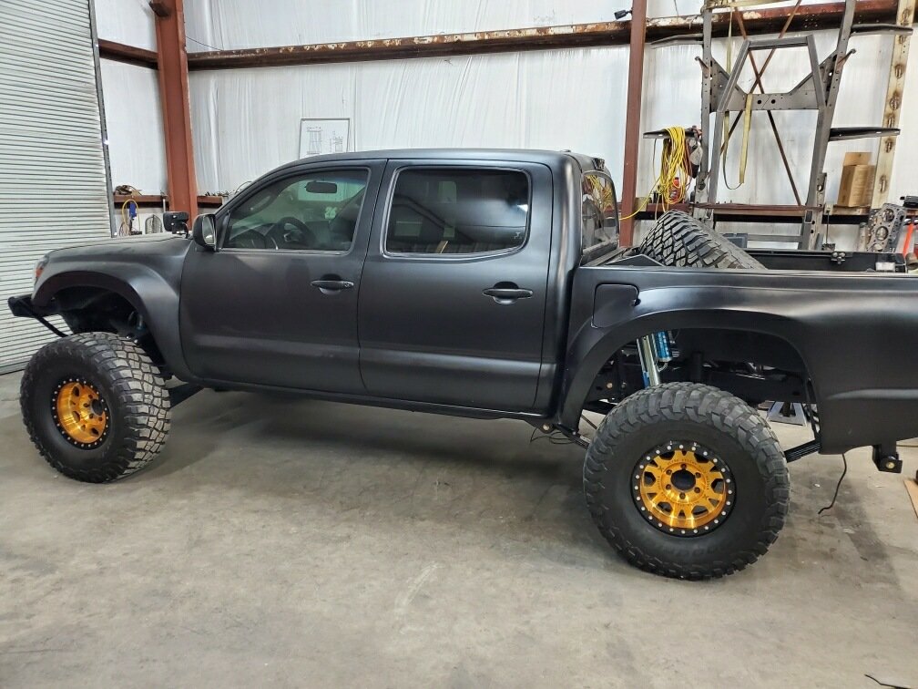

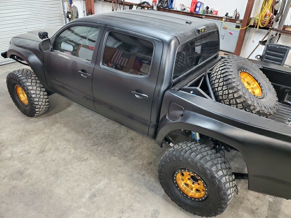

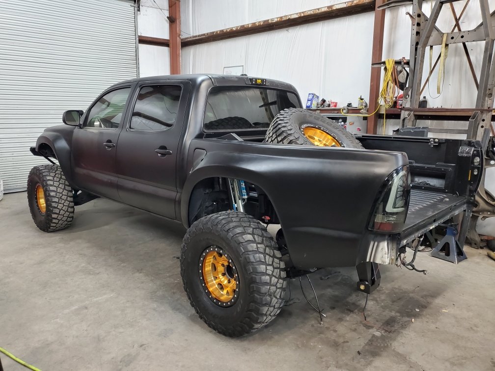

    1D98B563-7781-45BE-AA25-5B648AEC8022.jpg 7CF8809E-4253-4CE3-810A-6EF9A40EB256.jpg BC100F21-7240-46C8-8661-7468C36745CA.jpg Picking it up tomorrow after being in the shop for a few weeks. Had the dirt king spring under installed with custom bed cage.
