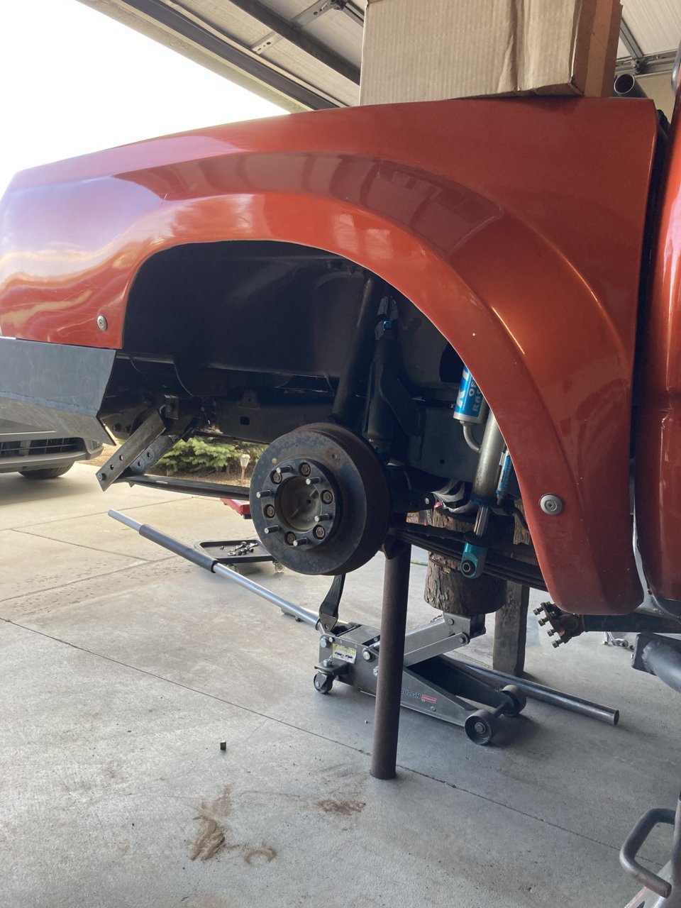

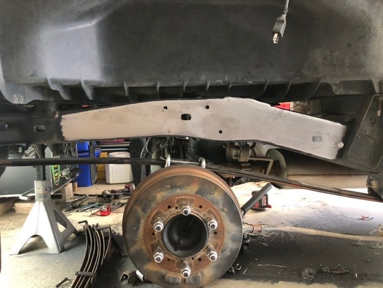

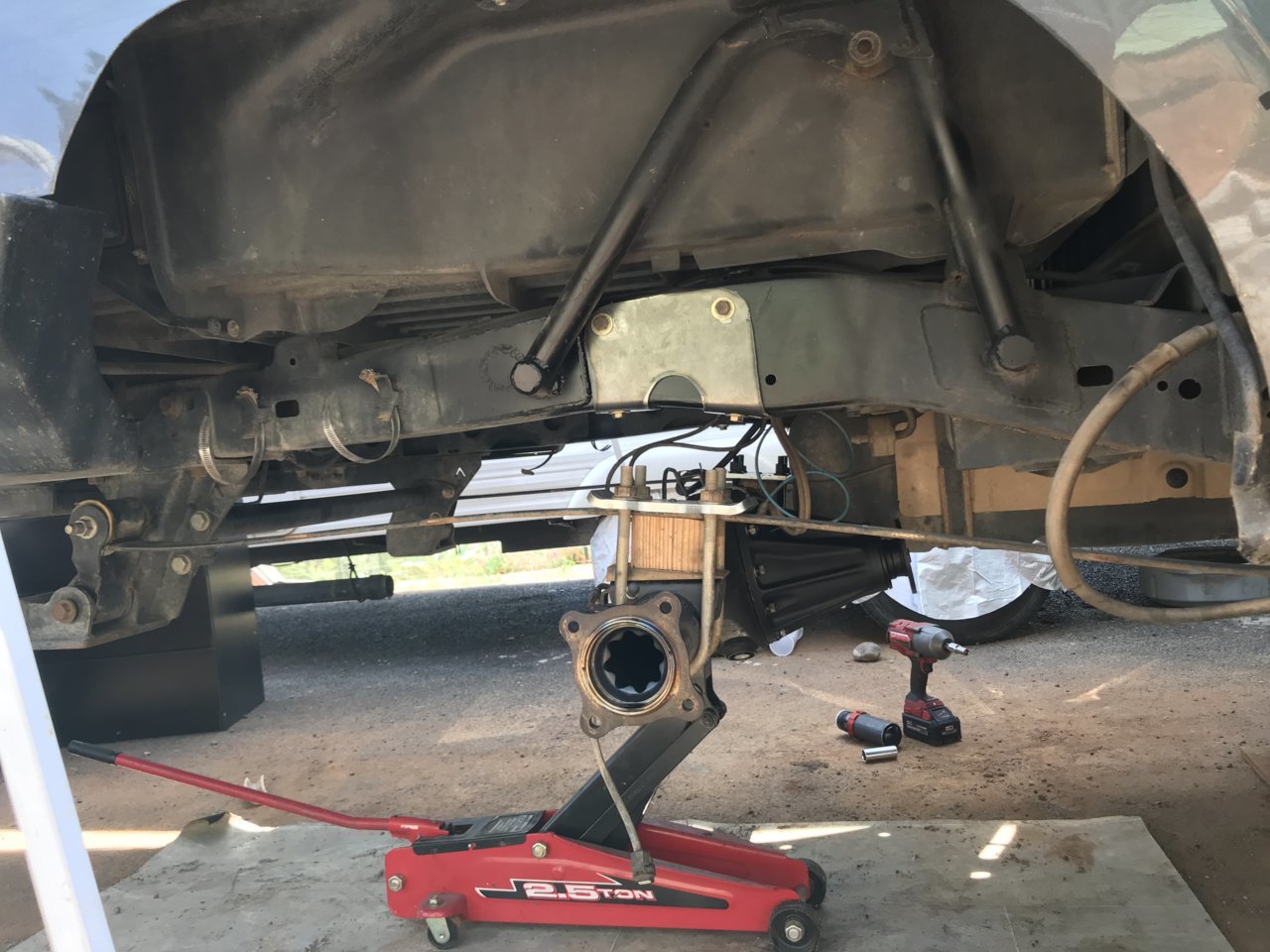

    Not really LT but probably the best area to ask. How much negative is too much? Cycling my Dakars and I'm going neg pretty early into the travel. Plenty of room for more bump before I hit metal to metal. Also running a .5" longer than stock shackle out of a 1st gen Tundra.
    I'd like to get more bump travel out of it but... o_O

    I was told from Tim at DMZ that once the leaf is “flat” you can go 2” higher on the axle into negative arch. He said you can run a setup like that all day every day and not have premature issues with the leafs. Which coincidentally is right about where his kit bumps the axle at the frame. Kinda why I don’t want to notch the frame for more uptravel even though I could probably get away with another inch or so with how little I drive the truck.

    @desertjunkie760 I'd probably not bump much higher than that. Looking back at pics of my new leaf revamp you can see I’m barely going negative. You’re already way more negative than I am. Just go sua or links and be happy lol

    yeah, Im trying to find options. I didn’t want to spend a ton of time on the rear but I also want to make it so I’m happy with the rear for a couple more years if possible.
    was thinking of trying the 4.9” shackles that @Supra4x4 has for sale but not sure if that’s a good solution. My rear ride height has always been too high so I wouldn’t be upset with dropping it a bit.

    That’s about where I set my bump at too. SOA with custom dealers.

    I see you cycled with two leaves. I was wondering if that was contributing to my strange angles. Might throw a second leaf in today and try again

    Yeah I didn’t give it too much thought, I knew it would still be soft enough with 2 in there, and it also matched the length of the wood block too lol
