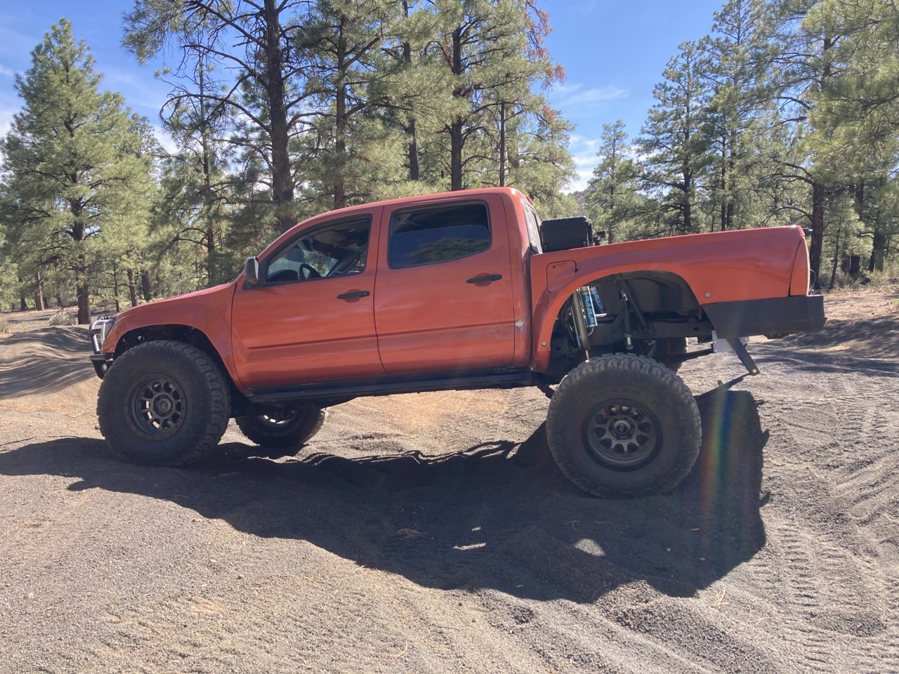

    So @Tbasch you have any axle wrap? Mine is crazy bad and gonna build an anti wrap bar

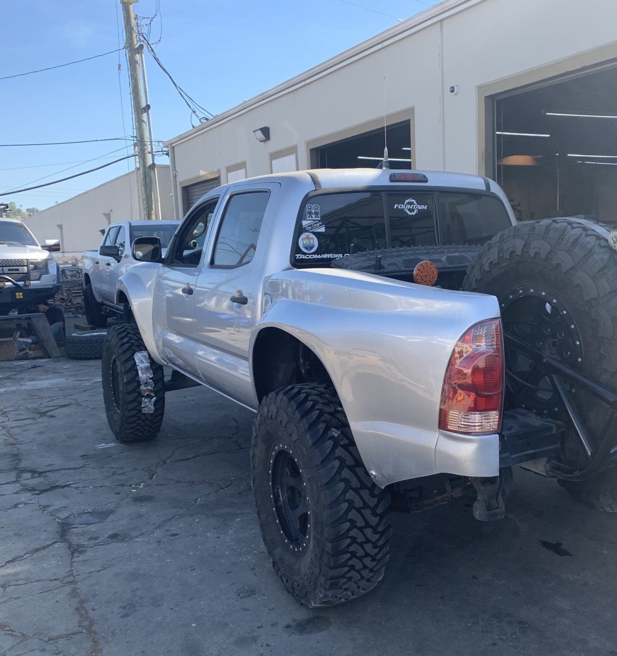

    I don’t have rear shackles like that lol Im running a DMZ sua, heres a picture but its a bad one lol cant find a good one rnB0F8A1E1-EE8F-417A-AC7B-C47E4922E086.jpg

    Gotcha, yeah I chopped my DMZ kit out and built my new setup. Nothing wrong with how the dmz kit worked, just trying to make things more ideal for my usage.
    So @Y2kbaja you have any axle wrap with your setup? How long are your shackles?

    12" shackles and yes, probably have axle wrap. But I cruise a little slower now and just pull the fun lever (4wd) whenever the road is inclined.
