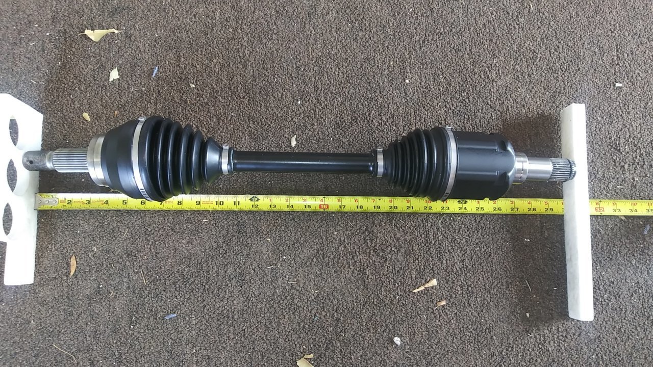

    29.75" DK brand new +3.5. Still waiting on triples and finding the time to install on my 03' V8.20210517_111505~2.jpg

    Here is what I found. Talked to CVJ today and the rep said to measure the axles compressed. He recommended to hold the axle vertically and compress down so you can measure from table to tip of the axle.
    Stock is 25.5” according them them. I measured 25.75” but close enough.
    The axles I have are 27.625” give or take so they appear to be 2” to me. Huge relief though because that’s what I need.
