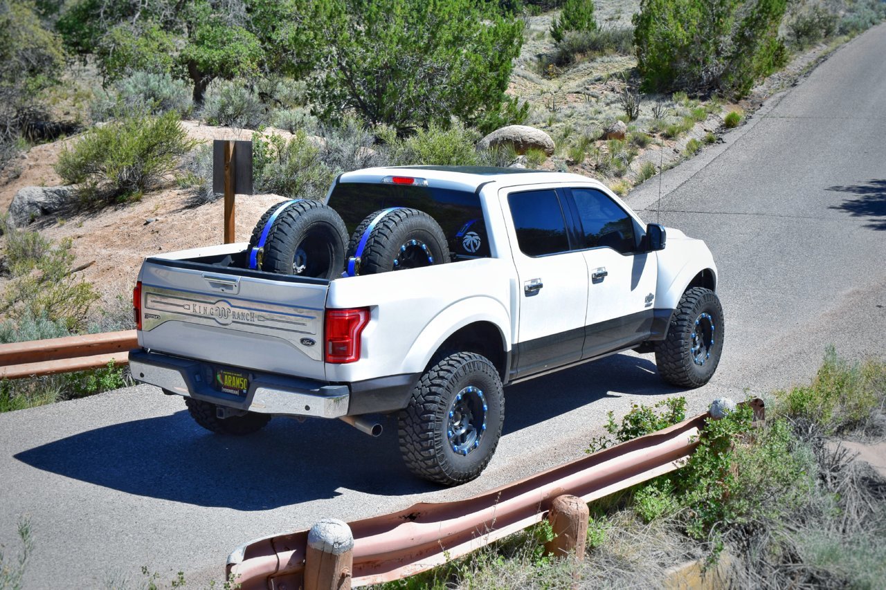

    Any LT dudes running dual spares behind the cab? Something I wish I would have done on my 3rd Gen if I went LT and big glass

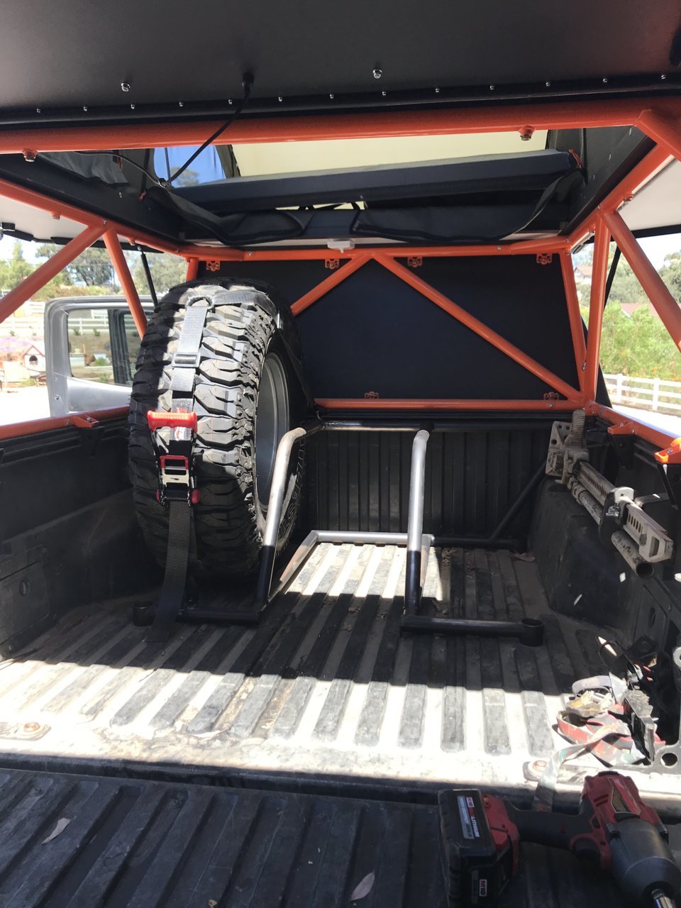

    Not LT but I built a single tire bed rack for my truck. didn’t see the purpose in a dual tire with the limited amount of space available

    This looks way better than mine. My spare is just ratchet strapped at the front of the bed with my jack strapped to the top.

    Thanks. It's nothing too fancy but does what I need. Overall I'm pretty happy with it. Eventually I would like to make a more permanent home for my cooler but haven't done it yet.

    Plenty of space to play with. How does the GFC hold up in actual wheeling and speed?

    Better than the truck itself actually. My bedsides did not handle the additional weight well and our trannys get HOT really easy with the additional load. Its off my truck now but I'd buy one again after addressing a few weaknesses.

    Chads_taco on instagram had two spares like that Ford. Although I think his was at the back of the bed.

    That's a bummer. They look great, and seem fairly practical. But yea with it resting on fiberglass bedsides i can see problems happening quickly. Then there's also that price...

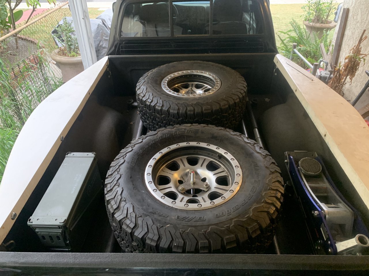

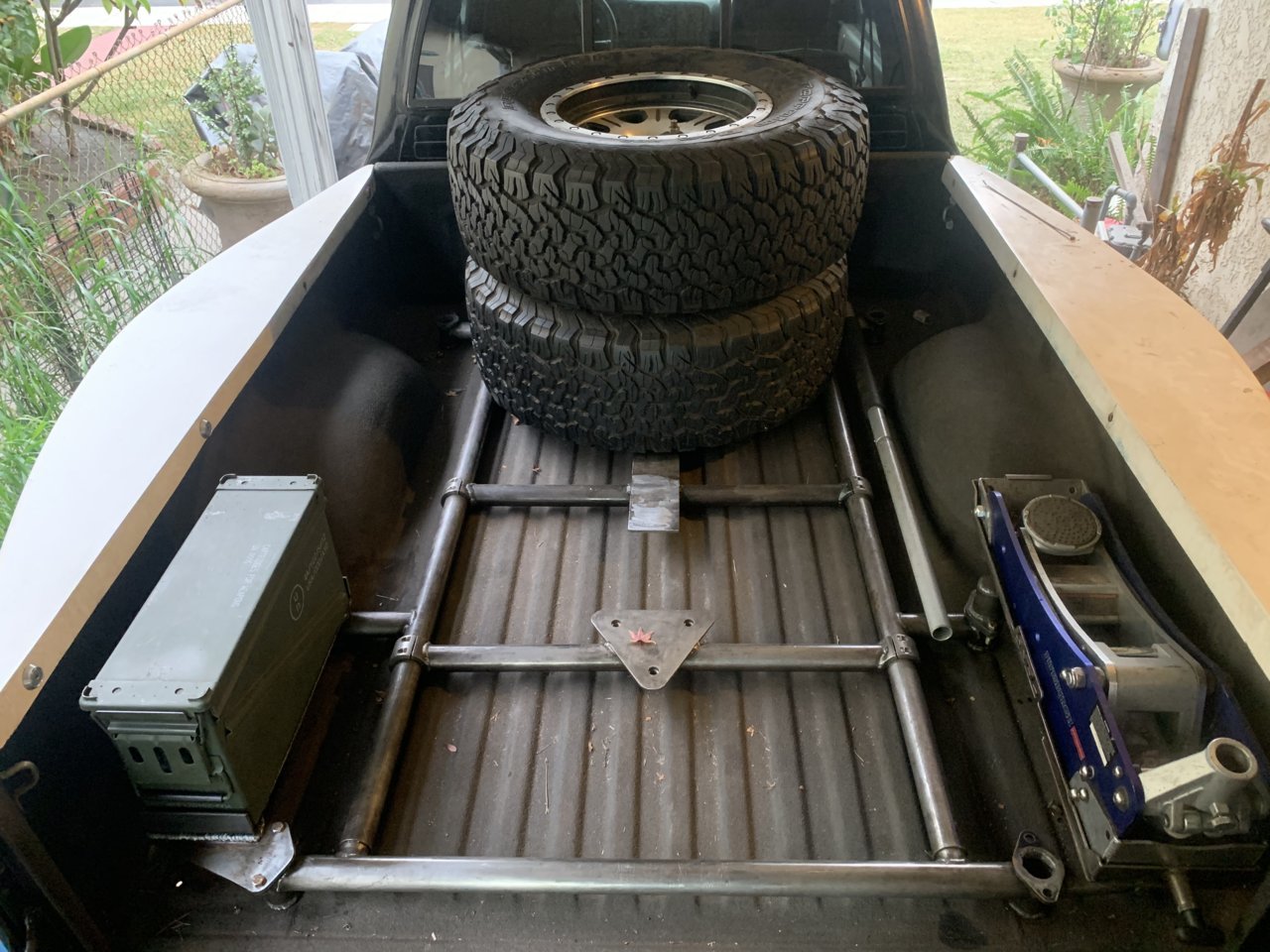

    I did something to allow for a second level to be added to my bed “cage” which could hold a tent or camper shell. 4 flanges would be bolted to the corners here.
    3C4FDCED-7284-43BC-8C69-14DF987129EA.jpg FF5B4378-9629-491B-961F-C19FD63093F4.jpg

    I don't even have fiberglass. The factory bed sides are not designed to hold that amount of weight consistently and actually wheel the truck. They have the metal bed rails which I didn't have at the time as it was supposed to be temporary, but idk if that would have even truly solved the issue. Best to find a way to support the weight via the frame and not look back.
