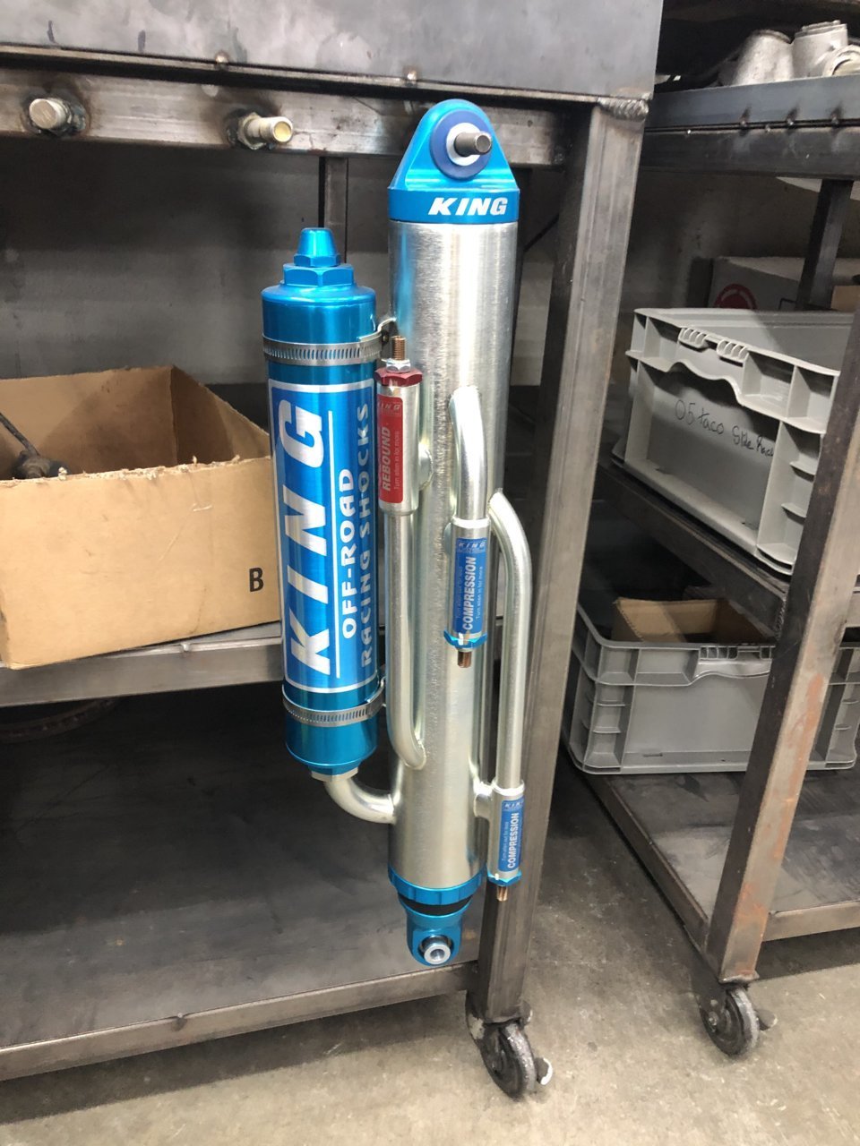

    Yup, exactly what @desertjunkie760 said.
    For reference my rears are valved at 15c/8r. Then the tuning of bypasses comes into play. The beauty of bypasses is they are quick and easy to adjust. Grab a notepad, drive the truck, document your changes, and see what makes things better or worse.

    Definitely not too little weight. But leafs do like weight out back. I actually felt a difference between my spare being at the front vs back of the bed. I don’t know much about the SAW’s but if everything is all the way open and it is still harsh then I would open them up to see what valving is inside

    I'll move the spare to the back of the bed and see how it feels over the weekend. I don't remember exactly how I valved them last, but it's either 10/12 or 12/10 and I want to say 2 free bleeds open. They are older SAWs but I believe the piston design is similar to King's race piston.

    Wait, what shocks are they?
    Edit: I found your problem. "They are older SAWs"
    Bandido and snowsk8air2 like this.

    Joking aside, you shouldn't have two bleeds open on a bypass AND your tubes open. You've got something else going on. Check the valving but my guess is the issue goes beyond that.

    Open up all the free bleeds. Shouldn’t have any plugged with your setup

    I'll rip them apart and document what they have and take some pictures of the pistons. When I installed the SUA I followed DMZ's instructions and everything cycles smoothly. It drives good but not good enough.
    I'll try do that when I open them up to inspect them.
    What speeds where you hitting on that video? I'm going to see if some friends are up to try and get some exterior footage of mine. There's a whooped out section I know I can take like 40-45ish in my truck.

    Yeah at least let us know what’s going on when you open them up.
    I was doing 45-50 maybe in the video. Whatever it was it was the absolute perfect speed to keep the tires on the ground and showcase the suspension working

    It’s a test in a way. The general concept of the bypass tube is to create bleed past the main piston. You have multiple tubes that create multiple zones allowing you to ramp up the dampening depending on where the piston is in the travel. There can be multiple reasons for harshness but you have to start somewhere.
    You can also have too much valving on the main piston that will create a “wall” when you hit the bump zone, which may have been the case for you but it’s hard to say being every setup is different.
