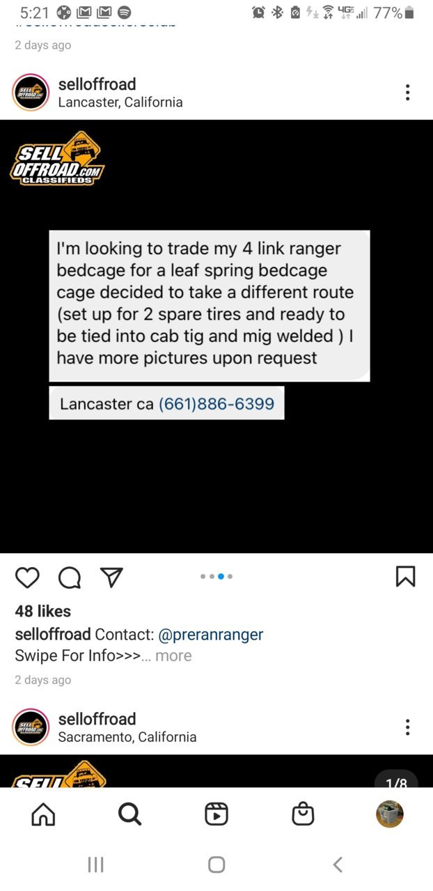

    People are wanting to trade their linked projects for leafs all thanks to your video :cheers:
