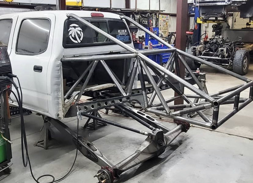

    Go full race truck or do a DMZ kit and save your wallet...
    5c04b729-4077-4463-a607-ae2200c4d5d3-jpe_4fbbff8958932c35b75d9bc083d4c25994bc98db.jpg

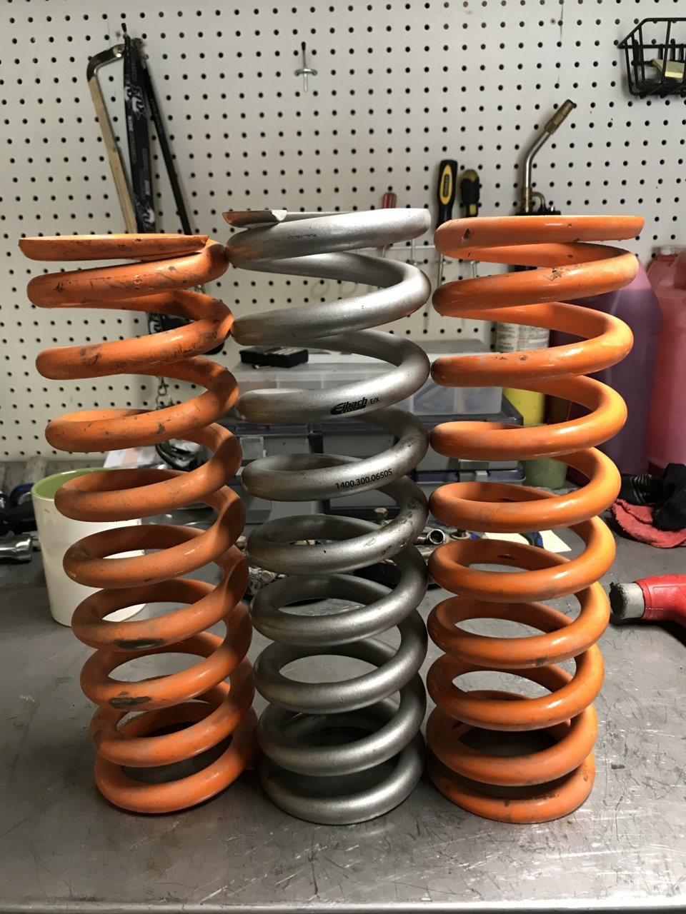

    9F3D5829-3ECA-486B-9342-44EC3CC3C426.jpg These held up really good and came out amazing!
