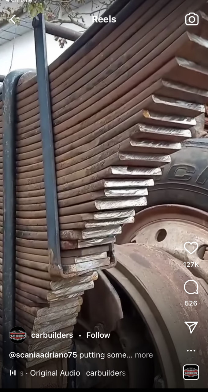

    Time for a better leaf company
    https://www.instagram.com/reel/CPmEAOAgLqK/
