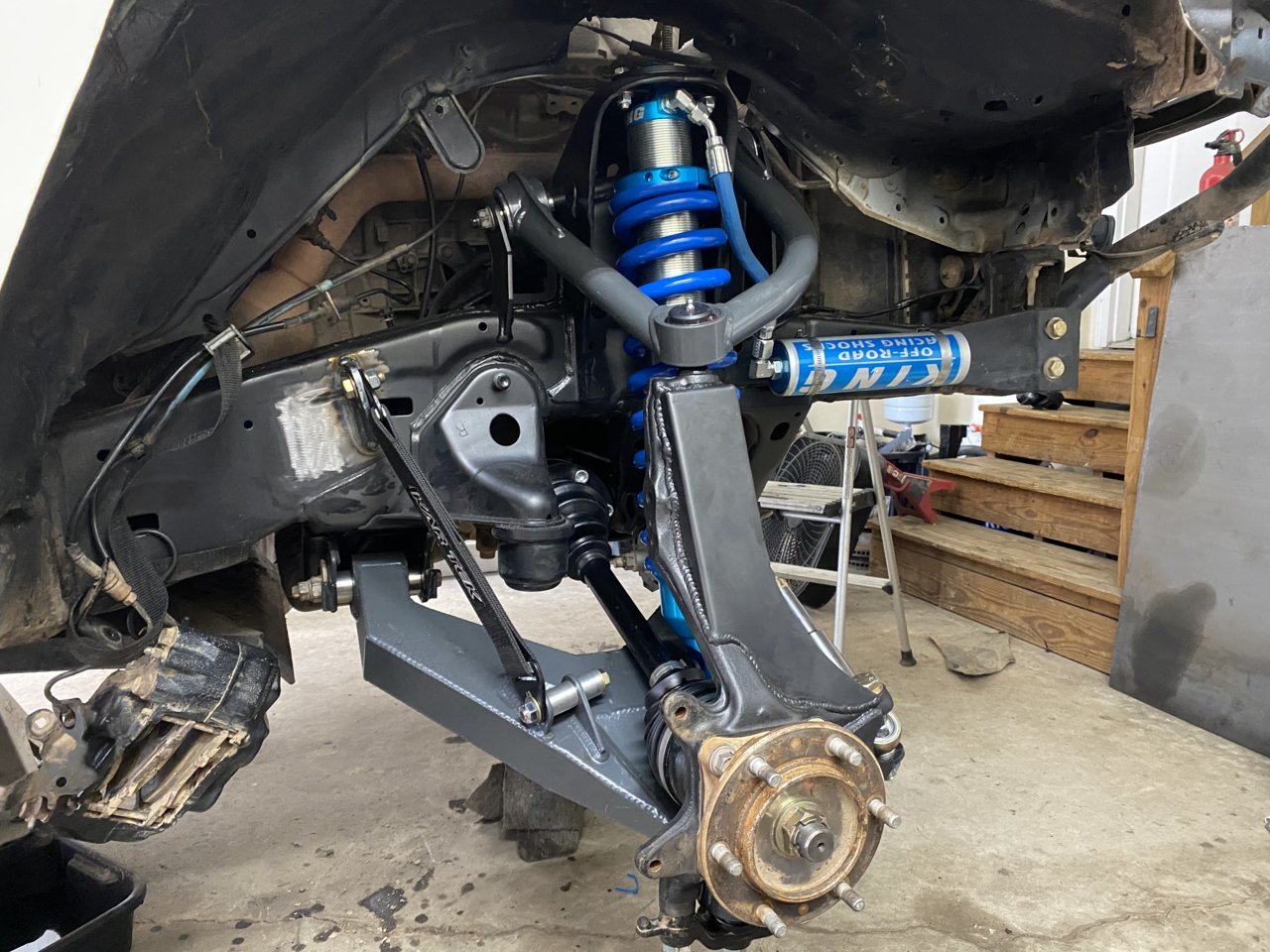

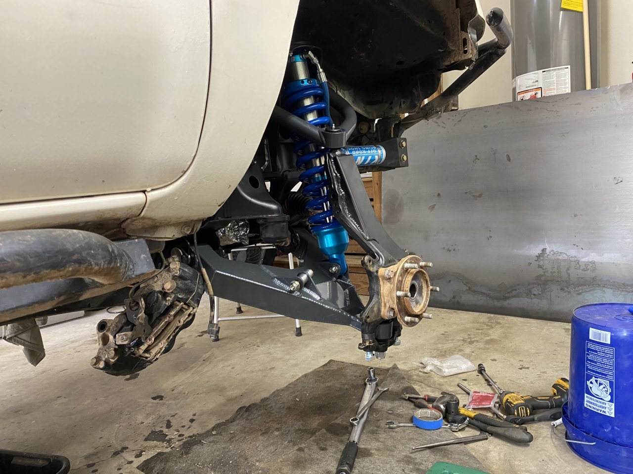

    One side done (ish) and should get the other side done tomorrow.

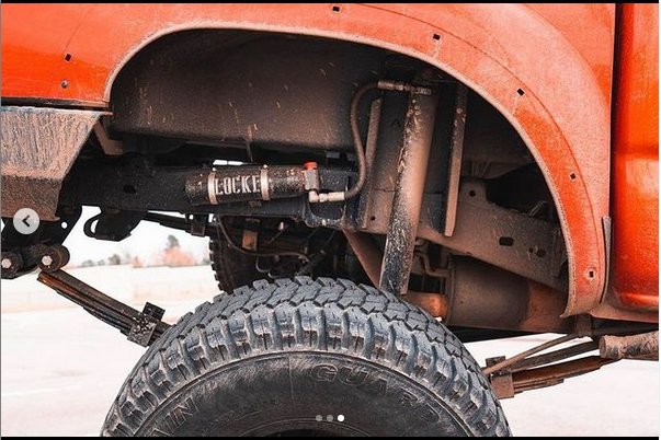

    I'm keeping that auto-correction in my quote, Lol. The fittings are not orientated anything like I ordered them, I can turn them but they're way off. As for the body cap, it might not clear my Archive relocation towers. Pictures speak louder than words, I ordered them like this:

    what’s more interesting is the shock in the picture in no way resembles what you received. The body cap is internal thread and the adjuster is a completely different design than the Fox knockoff you received.

    FWIW the resi in the image does not have separate hi and low speed adjustments and the one he received does have HSC LSC
    Kinda’ curious about the patent comments too…a lot of shock mfgr’s have had hsc / lsc adjustments for a long time do you guys just think the knob layout is patented ?

    Move your upper limit straps mounts. You want the strap pulling dead straight if you can. Otherwise you are asking to bend tabs

    I’m mounting them just like Harry from JD does.

    I guess the spacer puts that lower mount in double shear, but still I’d try to keep that line of pull as straight as possible if you can. We’ll double shear isn’t the right word. But it adds strength

    I looked closer at the pics and I was wrong. I put it on the wrong side of the rectangle in the frame, so it is at a bit of an angle. She staying tho, should be fine since all I do is crawl.
