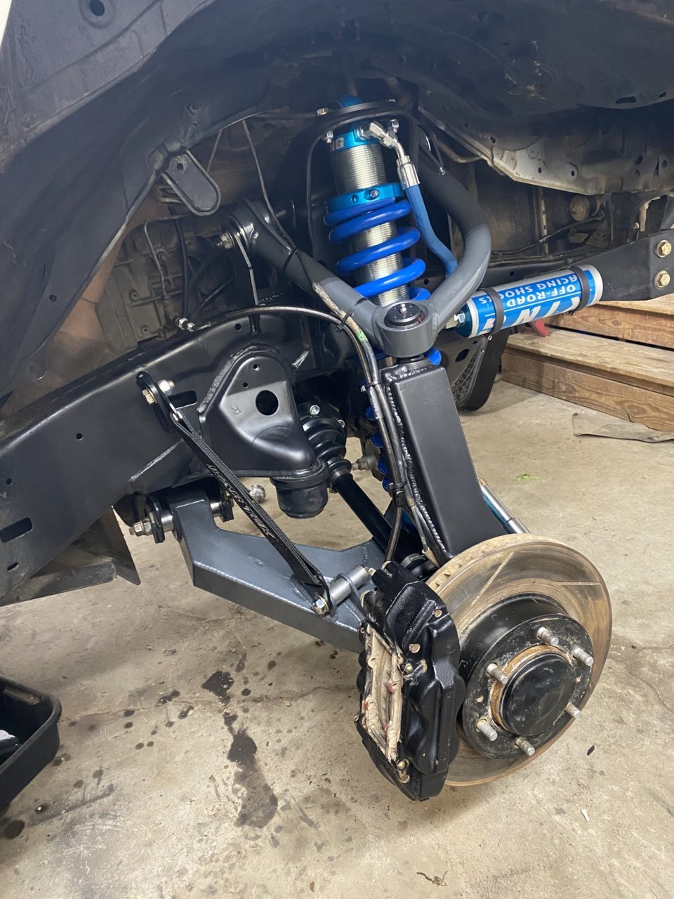

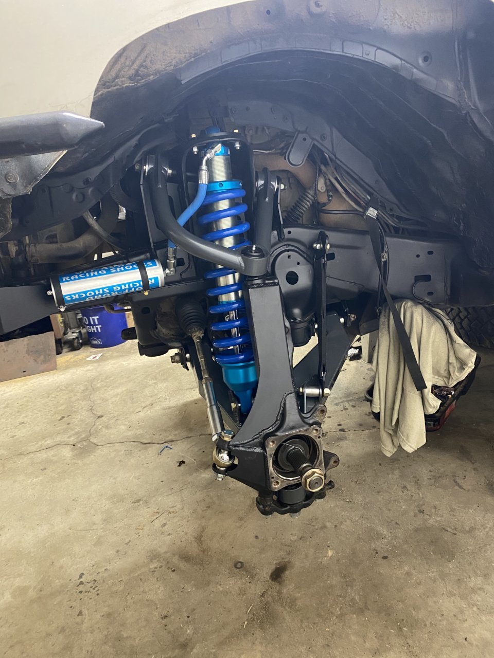

    She’s finally getting there. Decided to be lazy and not move the upper limit mount. I did place the other side correctly though.
    CAAEB0A9-AFF4-4DBF-88FB-DFC86EAF3D9B.jpg 1EDA3D26-CBA8-4306-BF4B-7D5E1599354E.jpg 2982558A-426E-4FB5-82F7-43FCC5D97031.jpg
