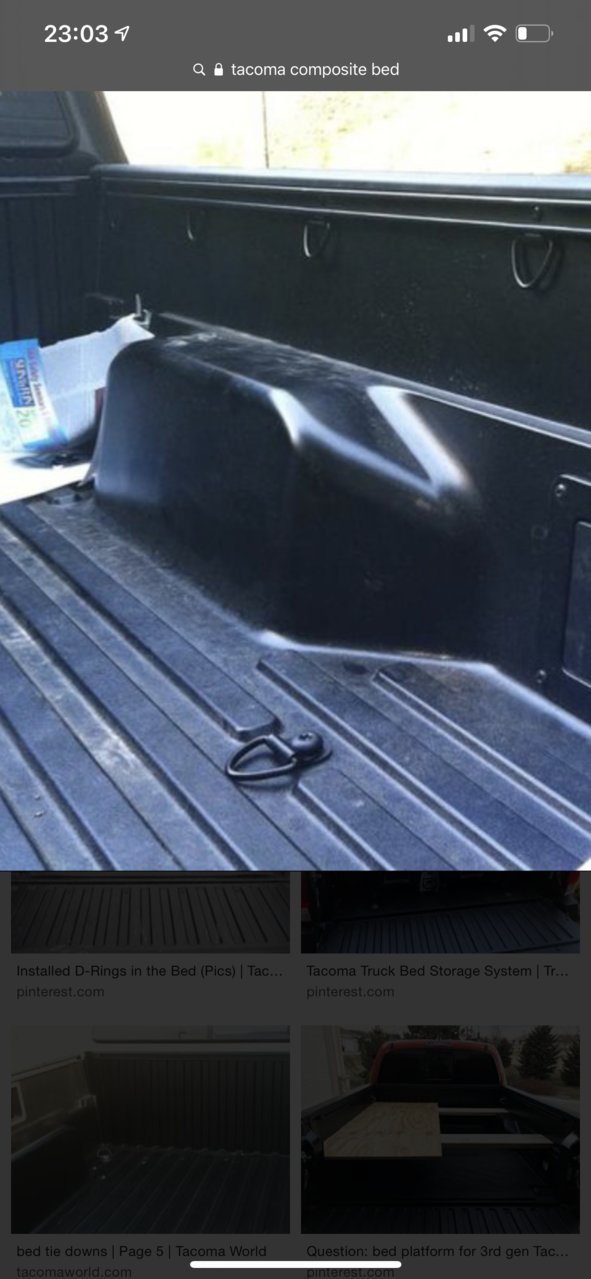

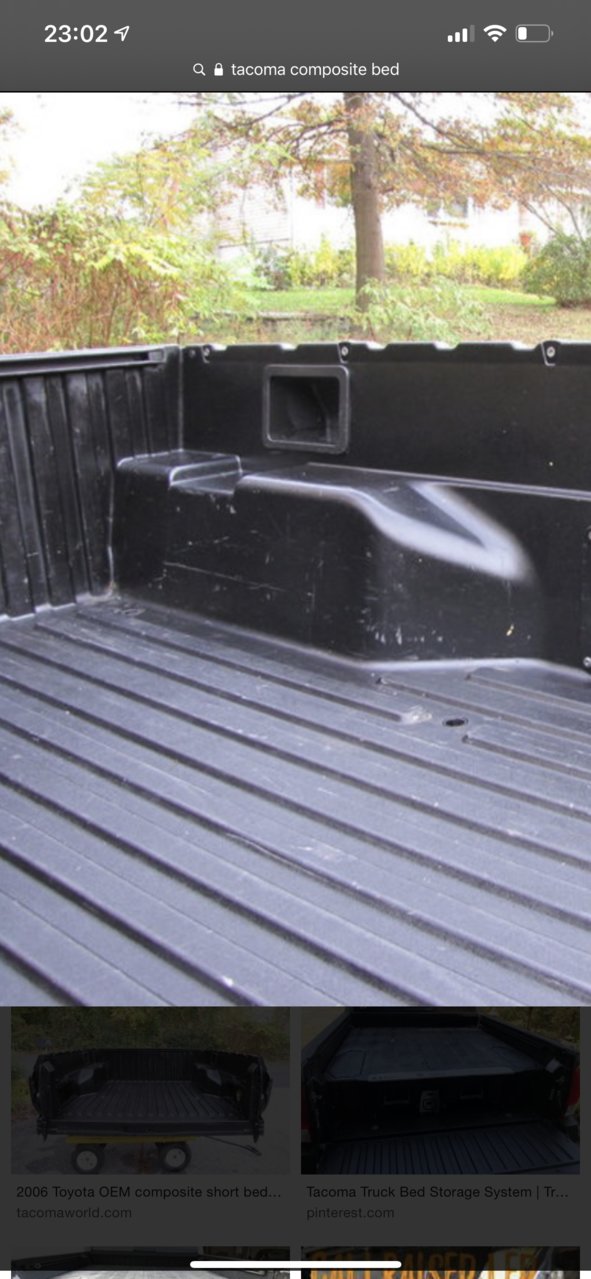

    Damn man. I'm trying to get my first Lt kit on my 2nd gen. All I have done to it is install an old man emu kit. There just so much to lt kit that I think I'm just going to do engine mods first and figure out all that later haha.

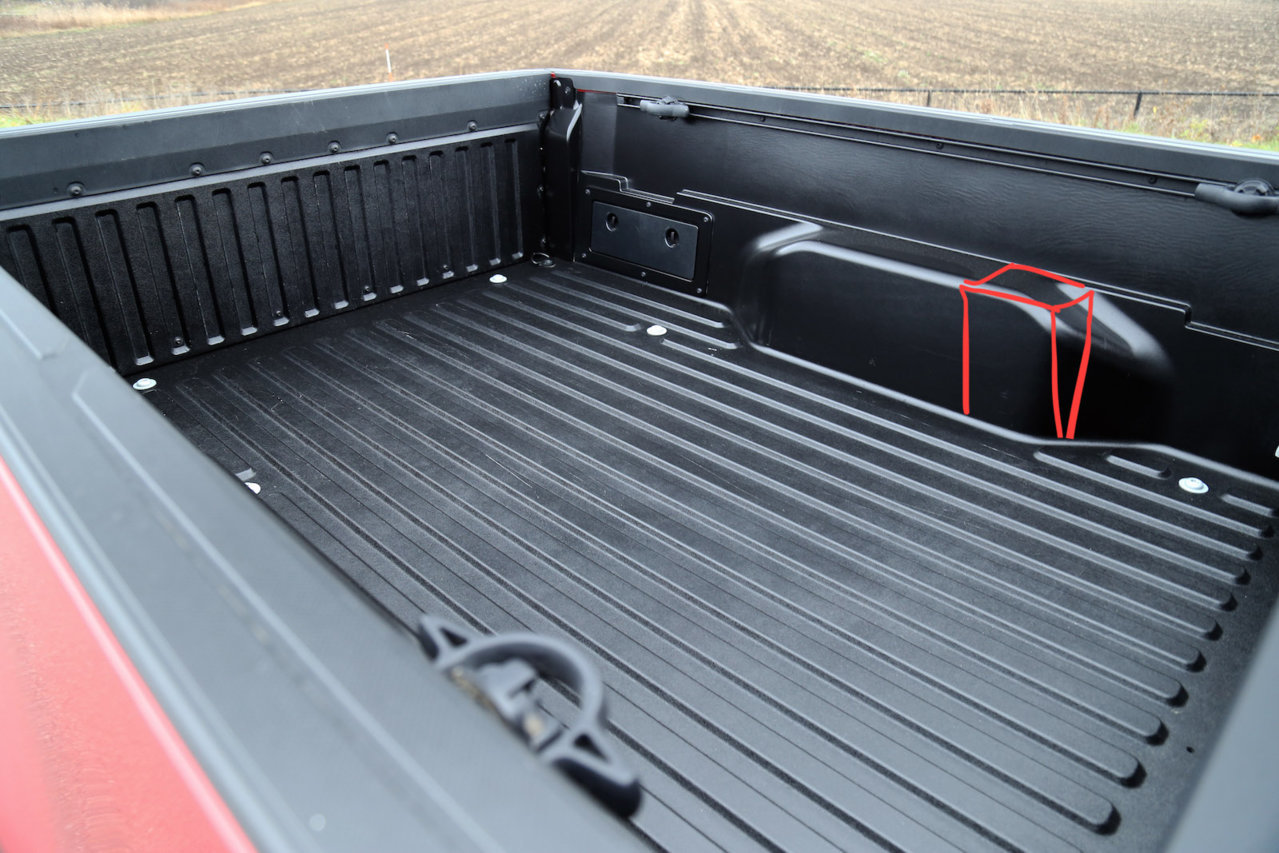

    Dang... I hadn't noticed the cutout on the short bed until now. I've only owned DCLB tacomas lol...
    Edit: I do recognize that the bed would probably still need to be cut though. IDK, this is all stuff I'll have to figure out after I get the front sorted. I still need to order some 934s from Harry

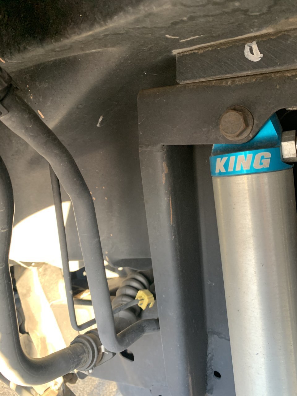

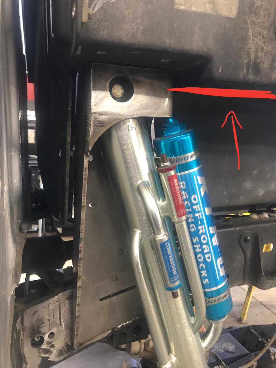

    Is there uptravel to be gained from putting the archive mounts up higher? Would it cause the shock body to run into the frame at all? I have that kit ready to be installed with a 14in shock and was also planning on doing without that little block if it worked with the shock stroke

    The AG kit runs the shock as close to the frame as possible for tire clearance, but you can’t run it much higher or you’ll have a gap where it welds too the frame. I like the archive kit, but a 14” is too big if you’re going SUA with a bypass on it. If you’re SOA, you can set the lower mount with 6” up and 7” down which isn’t so bad as long as you can get the leaf to cycle it (granted your truck would be super tall at ride height), but with SUA your lower mounts would have to be stupid low. I didn’t set mine up right so don’t be like me.

    There is that little gap if they get pushed all the way up but it'd be easy to fill and just tig welding the sides alone would be strong enough. Was just curious if anyone that already cycled theirs had figured out whether there is more uptravel to be had there.
    I only have the 14s cause i got a sweet deal, woulda gone 12s if not. Just smoothies not bypasses so no worries there
