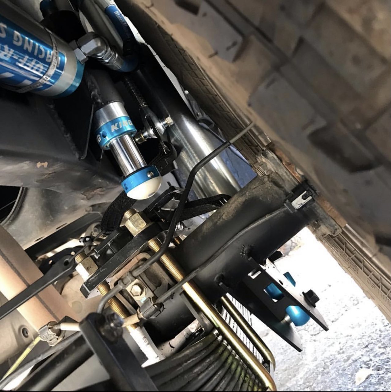

    Thanks! If ya got any pics post em up! be cool to get a visual too

    These are the only thing I could find from a few years ago. Trying to flex it out to see how much room I had off the shock without spacers at the time. I’m sure I would still rub at full bump and articulation but I’ll rarely see that condition.
    not_nick[QUOTED] likes this.

    excuse my ignorance, whats with the bungee?

    Looks like it’s keeping the limit straps from flying around maybe?
    Slashaar[QUOTED] and RonRon23 like this.

    Exactly. Just keeps them oriented the way you want them to be

    yeah. I let somebody install limit straps without running it by me. I would of out them the other orientation. It keeps them from folding out under the bump stop or the wheel area.

    Damn, sweet setup. Not having to deal with spacers would be a big bonus. I figured if mine rub i'd rather try a more offset wheel first

    That’s with 3.5 BS. I’m running 1.25 spacers right now. Going to cut this all off and redo it soon.
