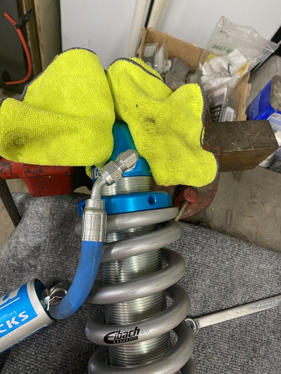

    I put on some 18” x 500 coils today. They barely squeeze onto these 8” coilovers but they fit and I couldn’t be happier. This is as much preload as I can add before the coil would hit block height and bottom out (at full compression). Gives me about 1.5” of lift and should articulate nice and easy in the rocks which is where Betty white likes to be.

    Why an 18" spring vs the normal 16" spring? Is it so you have more built in preload and can run a lower spring weight?

    Yep exactly. The downside is less adjustability. I’m maxed out on preload because if I move the upper collar any lower, the coil will bottom out before the shock does. But I’m right where I want to be ride height wise.

    I swapped over to an 18", 500 LB Spring right before this trip. It was noticeable and better through the rocks. Body roll got worst but I'm also 4 linked on 200/250 springs in the rear without sway bar. Still hasn't taken out the nuisance rock chatter but better.
    Dual rate on an 8" coilover might be next......... @desertjunkie760
