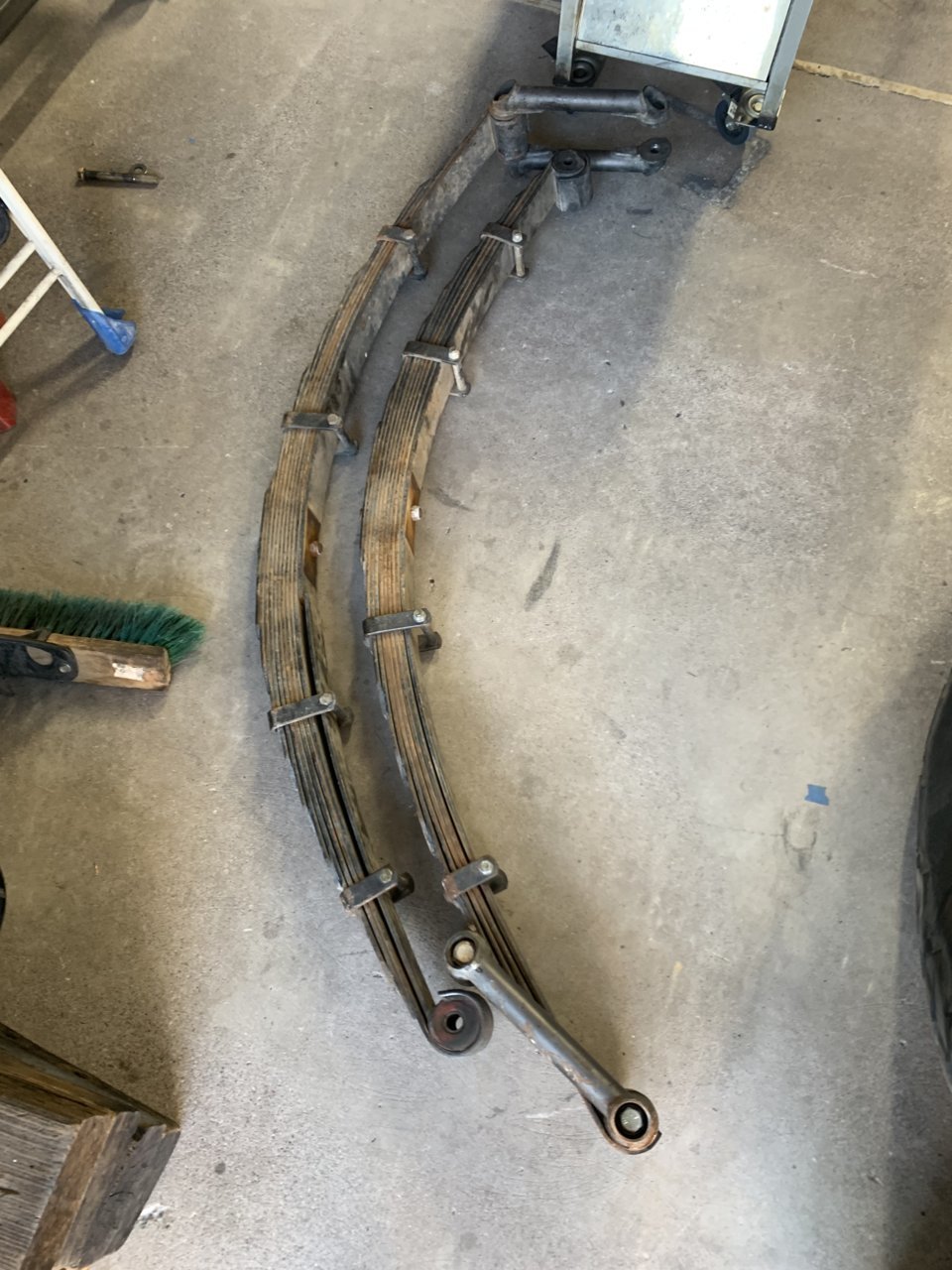

    So picked up a set of deavers h70 62 in springs for stupid cheap (main leaf on one was broken but rest looks good). Currently running chevy 63 main with a bastard pack. My plan was to run the h70 pack minus the main under my 63 main. I’m staying soa for ground clearance with a triple bypass. 6 in shackle below the frame.
    main question is will I see any down side to staying with the 63 main vs ordering a new main for the h70 pack?

    The geometry with a 62” spring is so good I’d consider getting a new main and remounting your springs. All I can think about is the silver sas’d terra crew first gen that does so well through whoops and crawling that has the same setup as you’re almost going with, with 62” f67’s meant for SUA but mounted SOA and I want to say 12” shackles above the frame.
    Here around 11:15
    https://youtu.be/2rTlx96YGWw
    You’ll get 1-2.5” of lift over the f67’s I believe.
    4F4CAE9F-6CEC-4A50-92CE-05475A0F9094.jpg 00B48493-1187-417C-861B-4FB3232387E2.jpg
    That said it would be more scientific to try out the 63” mains and see if it makes everything perfect lol.

    thanks. The silver ones are more what I’m after performance wise but I think like you said, I’ll try the 63 main with a 6 in shackle first. See how I like it then consider going to on top of the frame with a 12 in shackle.
    I don’t think a 9 in shackle would get me over the frame. Probably like others mentioned in the middle but I’d have to mess with a tape measure for sure. More than likely if the 63 main doesn’t do what I want, I’ll go to a 12 ish inch shackle over the frame to correct the shackle angle since the deaver springs are an inch or 2 shorter than actual Chevy 63s. This way I get full use of it with a bigger shackle and then maybe hopefully can cycle a longer shock in the future
