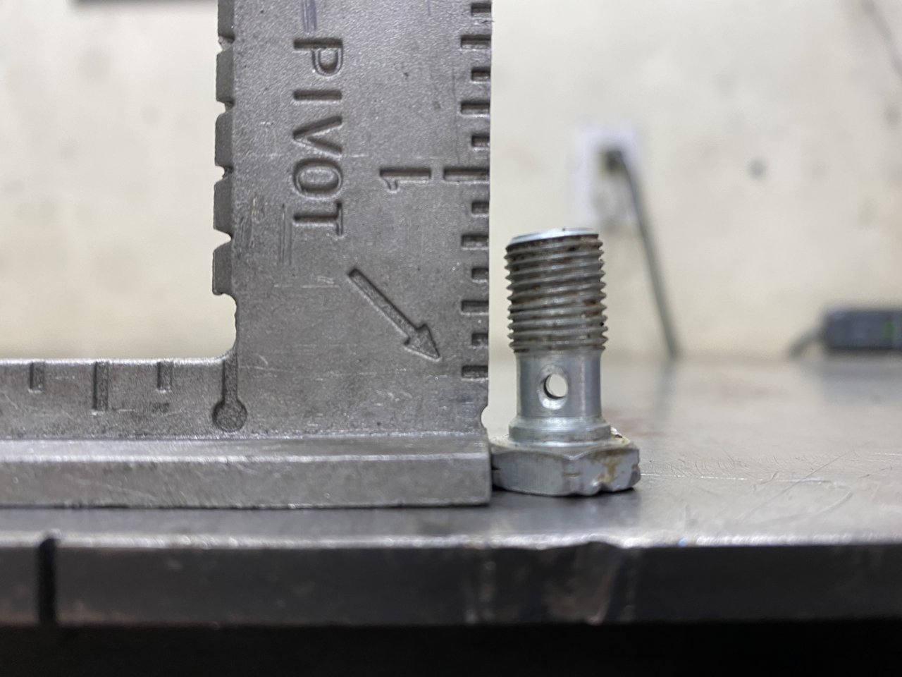

    I figured it out, M10x1.0. All the ones I found online were a couple mm too long until I found this bike shop in TX.
    https://shop.revivalcycles.com/10mm-banjo-bolts/

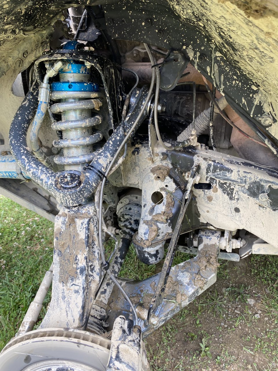

    Normally it goes
    junction -> hardline -> soft line -> hard line -> caliper
    but my LT kit goes
    junction -> braided stainless line with banjo fitting -> caliper
    So you’re right that I didn’t have one stock. And I could have a screw on fitting vs a banjo bolt but this is a bit nicer form factor IMO. Plus now I’ll have extra line and fittings to carry as a spare if this ever happens again in the future.
