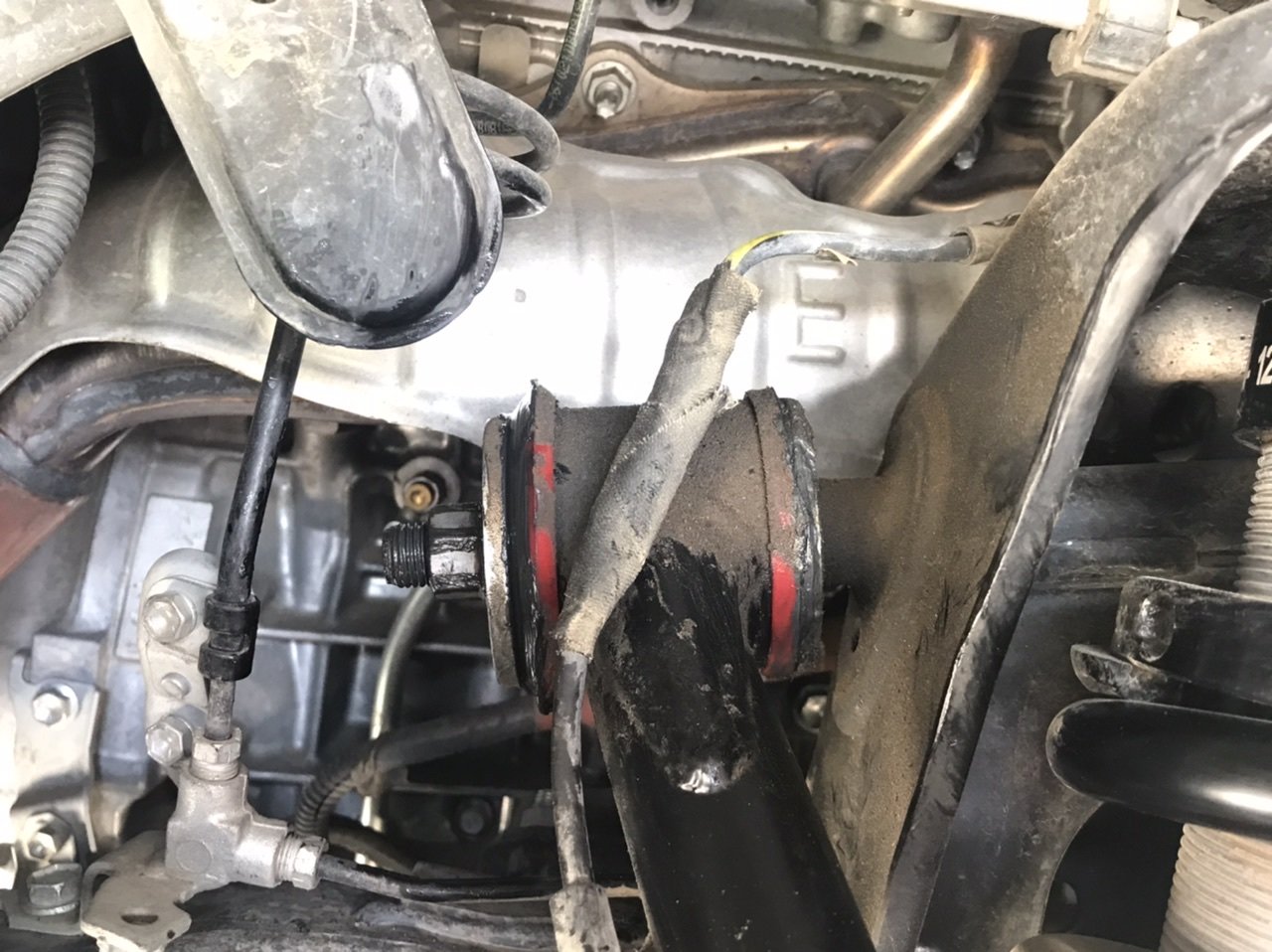

    I had tried both already… I backed nut off almost all the way and fucked with it and got the excess grease out, finally. Never had one lockup like that. Usually back off and releases.
    Just started as a “hey babe before we leave I need to hit these really quick” she went with out me. Now I’m relaxing drinking a beer with no wife or kids, thank you bushing lol

    Did you pull off the nut and the washer to see what’s happening?
    You could probably remove the bushing to inspect it and not remove the uca - just get some bolts to slide into the sleeves on either end to hold things together with something supporting the lower control arm. You could press the bushing back in by using some spacers on the opposite end of the long bolt so you just use the outer washer and nut to force it back into place after.

    I pulled nut off and was able to fuck with it till it finally let loose. Never had it so difficult.
