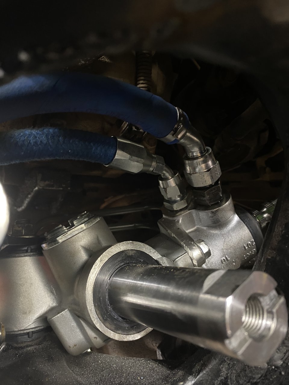

    Ahh, I see. Only way I could see this happening is create bracket that uses this bolt to stay in place, and then secure a boot to the bracket. But that would be a major pain to make.

    Thats where my brain is going too. I just cant think of an idea that wont interfere with the clevis.

    Damn okay, so it's even newer than mine.
    Just spewing some ideas here, What about modifying the end of the clevis to accept a boot of some sort? Or putting some sort of boot around the slide rack and rack all together? Maybe I will use my old rack to try and mock something up before modifying my new one on the truck.

    Yeah, Im going to take my old rack and Mimic the modifications done on the current one to see if I can come up with something. Ideally all of us guys with the rack can share ideas and come up with a solution that will work.

    Ah didn’t hear that you had to modify the rack for a slider. Here is the same concept on a first gen, you can see you’d have no issues on the rack side to add a boot.
    What about machining the clevis to fit in an unmodified rack?

    The clevis would need an entire re design.

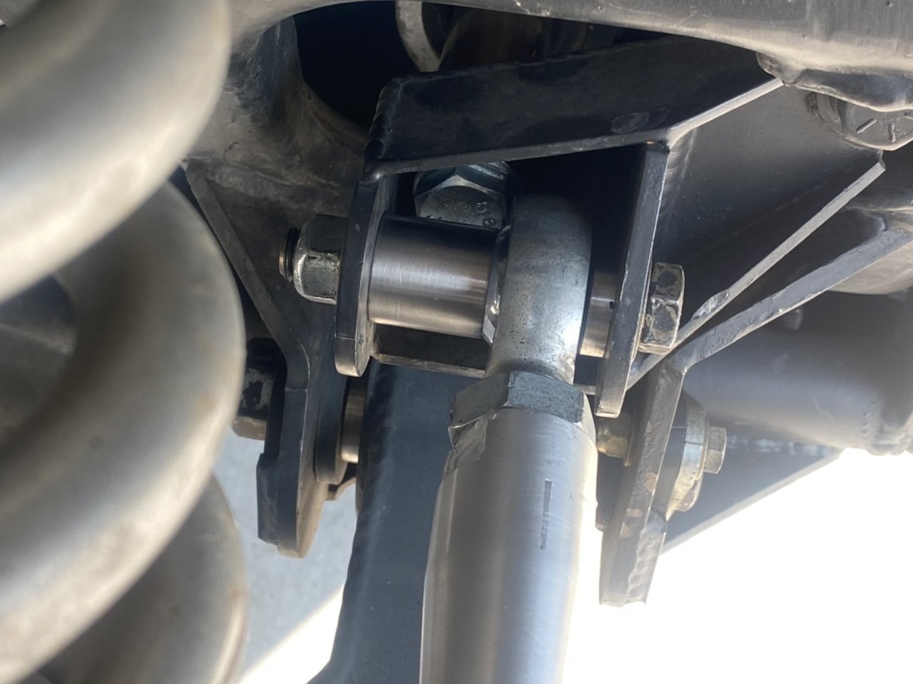

    It seems like they want the clevis to be captured by the slider bracket on both sides - I'm sure that's best practice in the desert, but if you're getting debris in the rack it would be good to probably make another mount that is compatible with the rack to keep the option of running a boot.
    Looking at it - I'm sure they want the connection between the slider and the ram to be good due to the angle of the connection between the two with the bracket they made. If it doesn't get too close to the coilover I don't know if the bracket could be flipped outward to keep the premise of the bracket and allow the clevis to slide into the stock casing for the rack.

    If the entire tie rod assembly was 1/2" shorter and there was a 1/2" welded on spacer behind the clevis the same diameter as the steering rack would you have enough room for a boot over the end with the inner sort of floating with a ring and a bracket to attach to the bolt shown a ways up?

    Negative. The only way Im seeing this happening is a complete re design of the clevis.

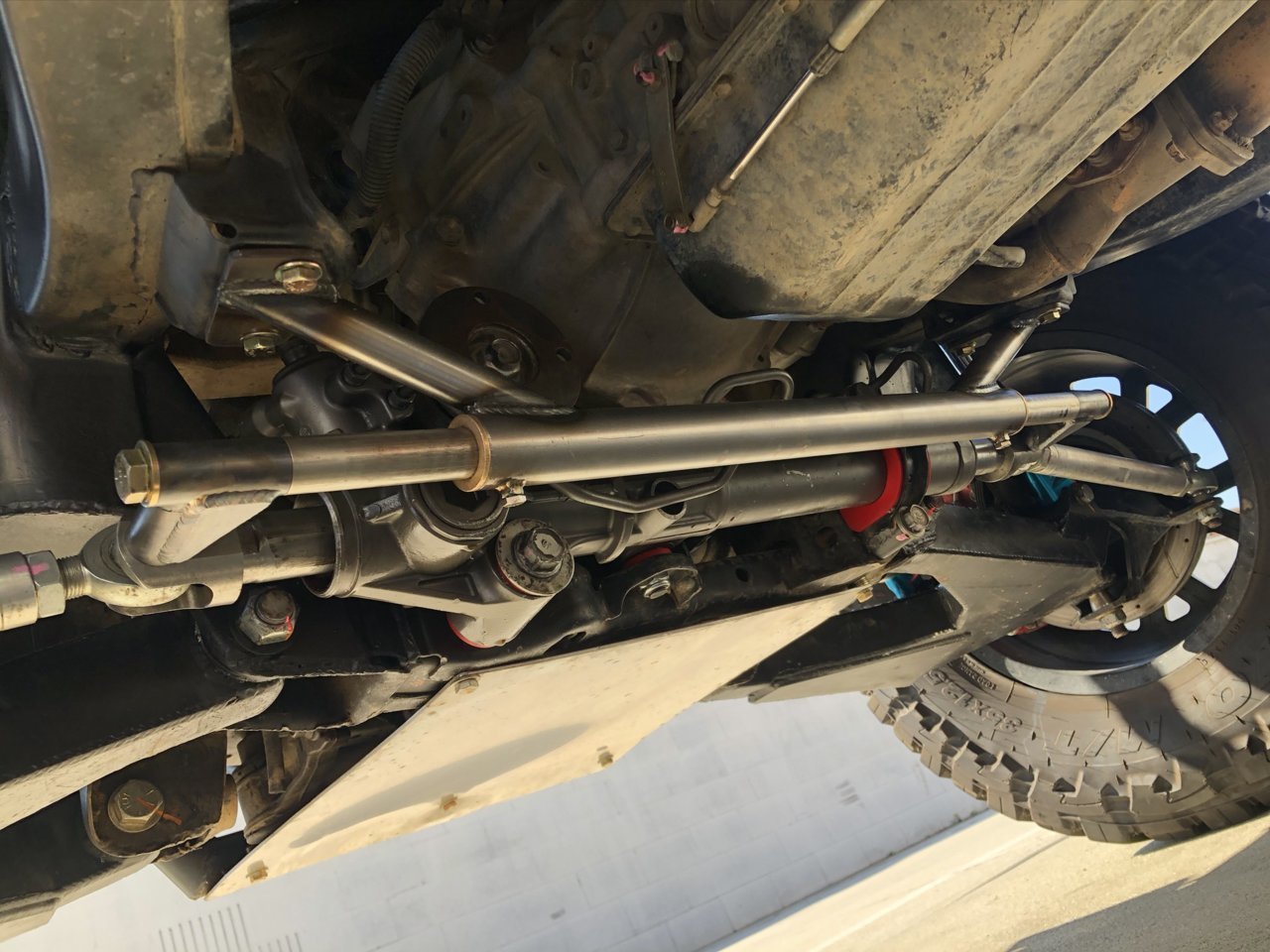

    https://www.tacomaworld.com/threads/airdogs-2012-prerunner-access-cab-slow-build.264263/
    . The inner tie rod tie is adjustable with spacers. Here is mine in the full forward position.
