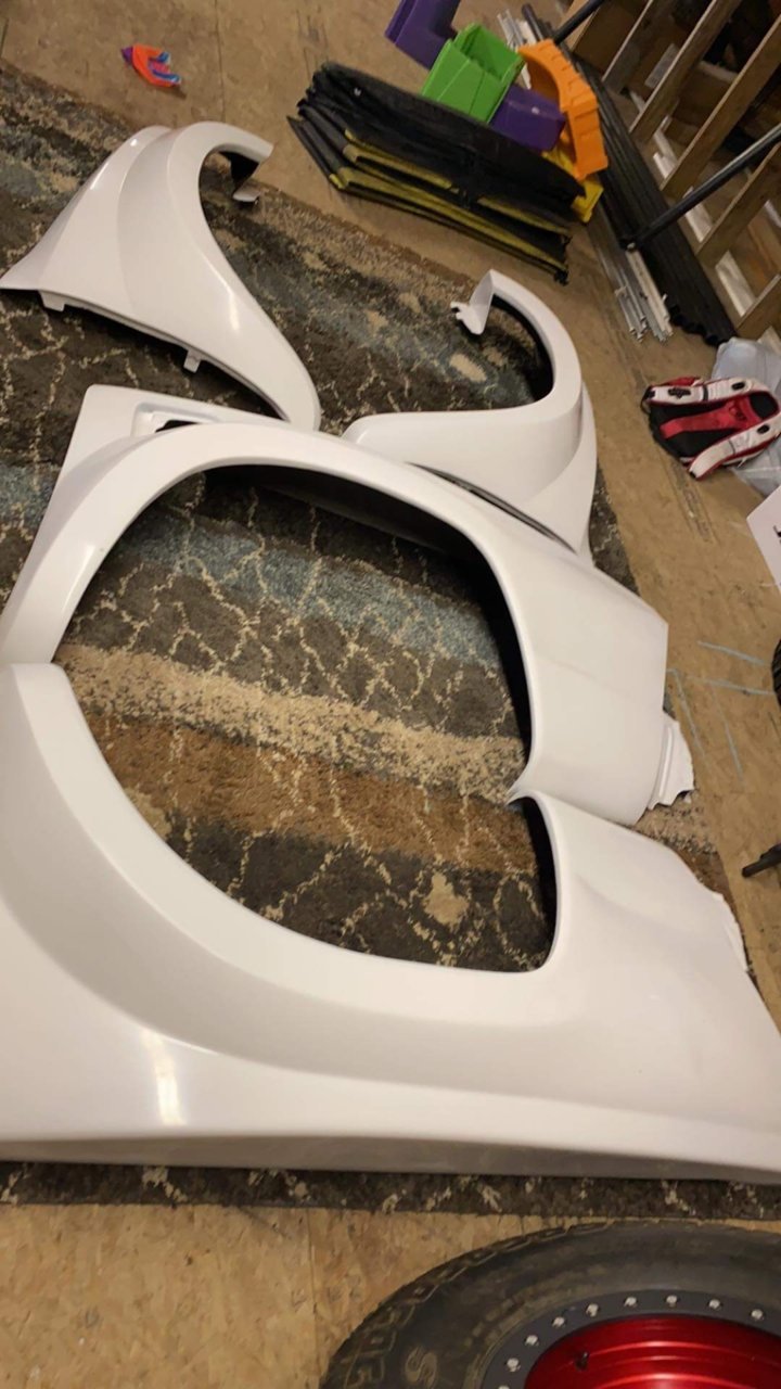

    well my buddy just sent me these since I don’t get home till Monday, now I’m all antsy to get home and install them!
