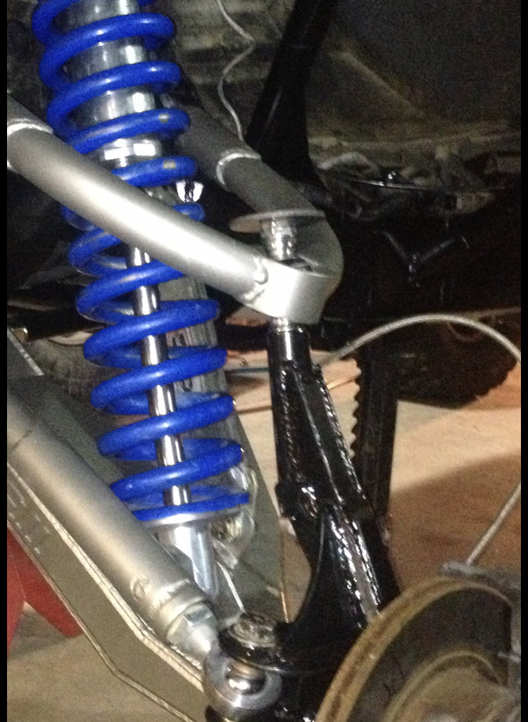

    Yeah like @atvlifestyle said you can build a vertical uniball bolt into a strike pad. The Camburg spindle definitely would hold the force. Michigan guys go much harder than 95% of the guys on here too. TT Motorsports said he had a truck like that - just have it aligned prior to setting up your bump location so it doesn’t hit unexpectedly on the side of the strike plate. Here’s an example:

    You can definitely bump off a vertical uniball bolt (OEM spindle styel), if you look around on google images you'll see some older pre-runners set up that way. just weld a plate to the top of the bolt and you're off.
    Almost everyone doing it now is building horizontal uniball arms though, because it makes other issues easier to deal with in the suspension package and if you're doing a fabbed spindle for a LT kit you might as well. Camburg designed that OEM spindle for people who kept breaking them, but didn't want a whole new front suspension.
