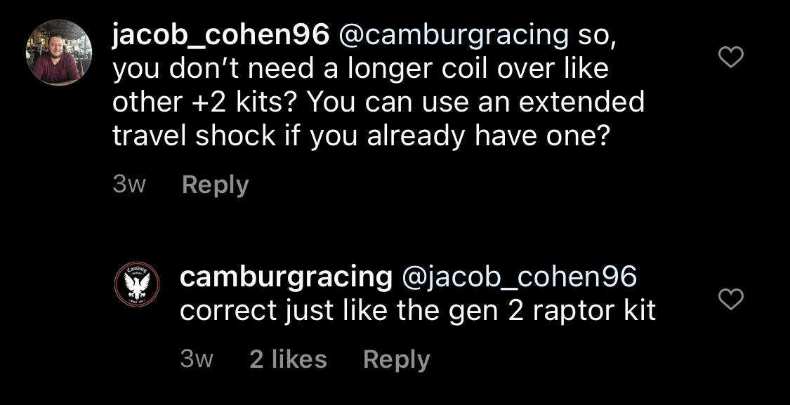

    let me repeat - i called them and asked them directly just a few mins ago, no insta, no fb, no twits

    It looks like the marketing department and sales department have different notes then because halfway through the video they posted on Ig it says it will use any of the aftermarket coilovers you already have ...
    https://camburg.com/shop/suspension...oyota-tacoma-16-trail-series-long-travel-kit/
    https://www.instagram.com/p/CRRYnSbBkyj/
    https://www.instagram.com/p/CRpYT9_Byp0/ This one is a little less clear but they say the following in the post "As you can see this kit runs most after market coilovers"

    No, I won’t be calling them because I really don’t care that much. But so much of the hype on the kit came around not needing a new CO, which was stated by the guy in multiple videos as well as whoever is running the account. It seems like there’s just a disconnect at Camburg, so I’ll wait and see when it actually rolls out.
