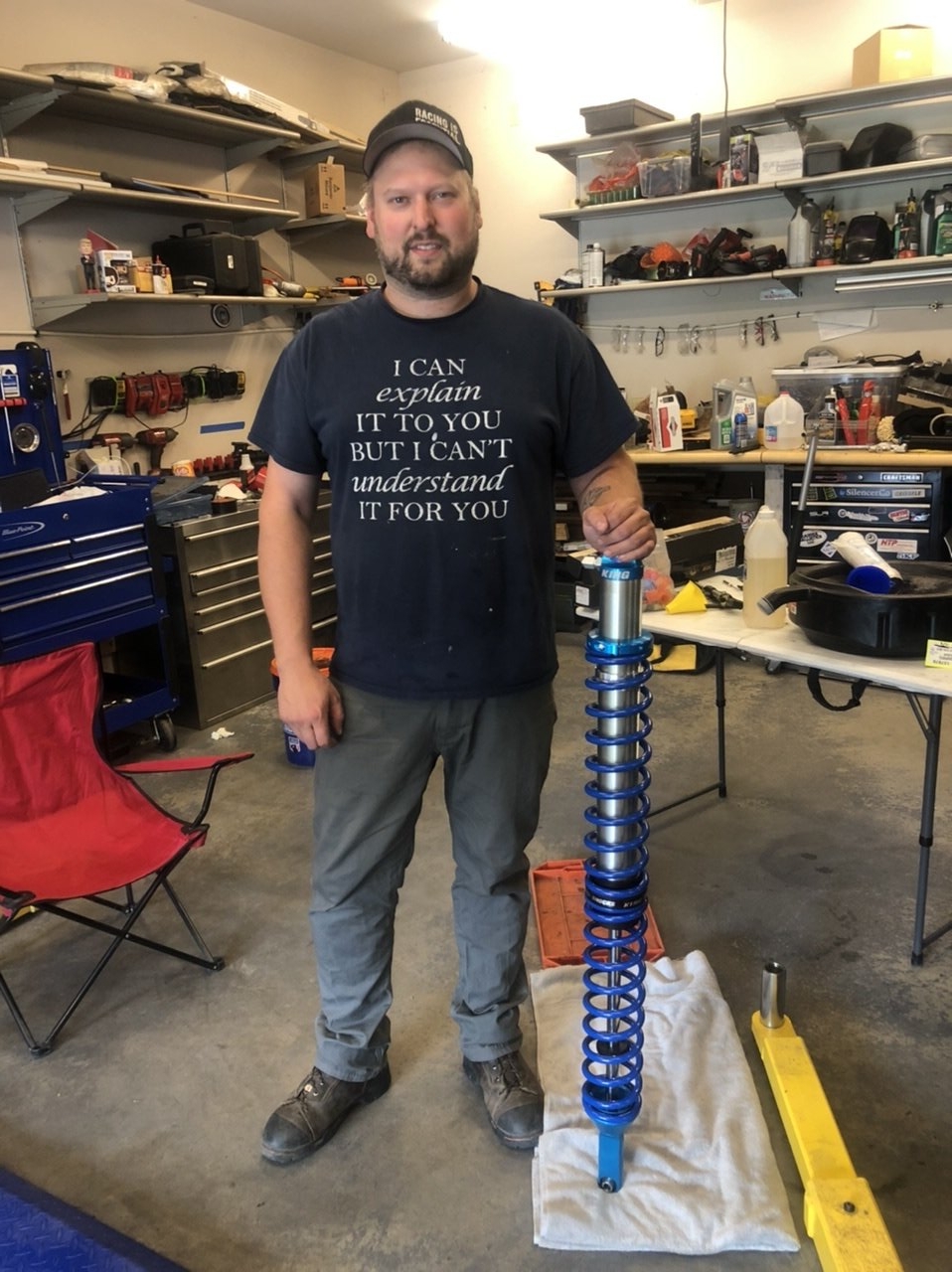

    now back to some regularly scheduled tomfoolery.....lmao
    Is it fall yet so i can these installed....now just waiting on a shitload more parts and time to do ALOT of work to the truck... these month's long projects just never end...
