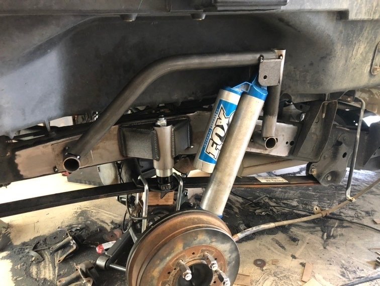

    I've been using ballistic joints on my rear 4 link. I haven't had any issues with them. Still on the same joints for 2 years. The delrin serviceability is nice as it wears, the joint allows you to put a spanner wrench on it to tighten it down to pull the play out of it. once the delrin runs past its service life, just order new delrin. longer life and cheaper long-term maintenance than heims. That said, the downside is the delrin - If you plan on daily driving, you may experience faster wear and will be having to service the joints every 5K miles. The way they are mounted on my truck, I have to pull the link out, tighten, grease, then reinstall the link.

    This is where i felt comfortable bumping mine. Don’t have any problems with leafs rotating. Custom Deaver pack with 2” hydros.
