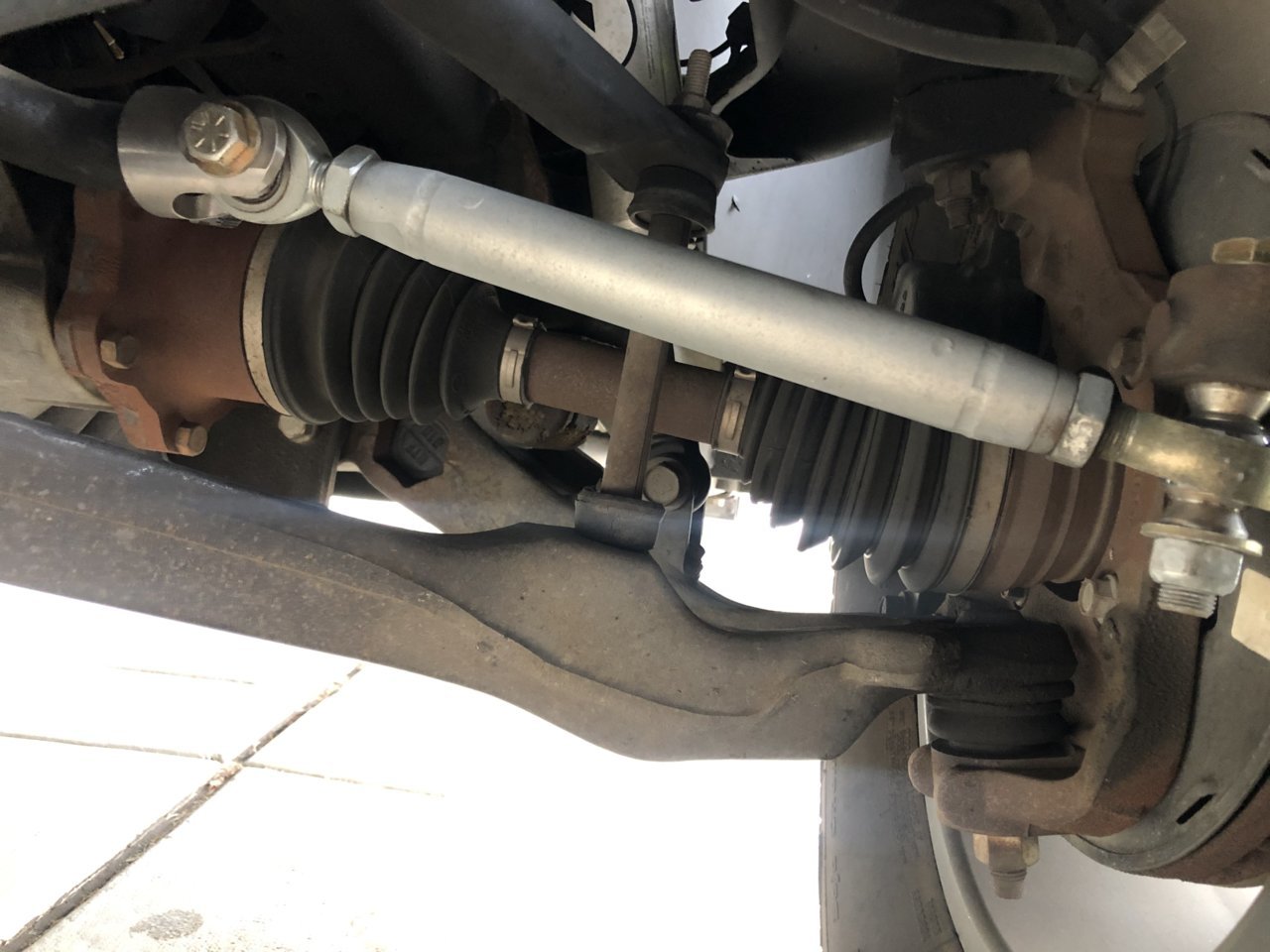

    The tie rods are machined for specific sides

    I more so meant does it matter if the heim is vertical or horizontal as the camburg adapters will allow any orientation.

    As long as they aren’t interfering with the clevis - vertical ish is how they’re usually oriented

    That’s kinda what I figured since tie rods will see more vertical movement than horizontal movement.

    The heims ALWAYS need to be vertical. You need to make sure to locktite the clevis in so they don’t rotate. Attached is a pic of my 2500HD for reference

    Red locktite on those clevis bolts

    Red loctite on everything.
