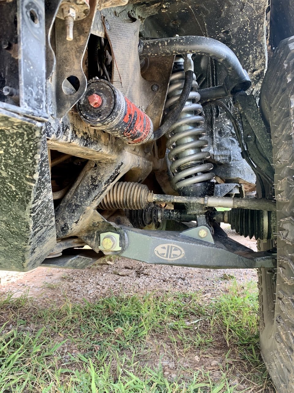

    whats your ride height? Looks like it sits low.
    I measure center of the top & bottom bolts on the shock for reference.
