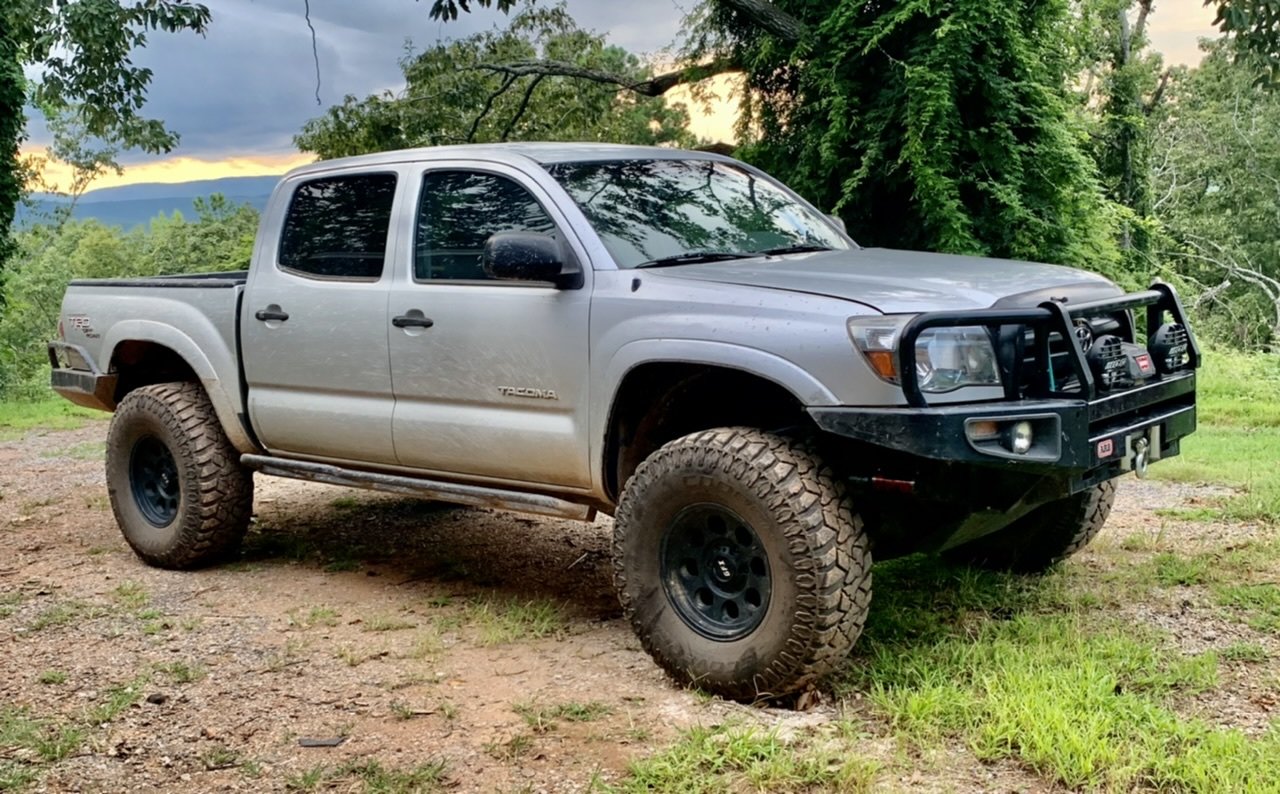

  18. Aug 21, 2021 at 2:18 PM
    Dayman Karate
    Dayman Karate Well-Known Member
    Dec 18, 2017
    #238838
    4,723
    Clay
    Central Alabama
    JKU Rubicon
    https://www.tacomaworld.com/threads/daymans-karate-class-but-you-wont-learn-nothin-4-link-lt-and-previous-iterations.755134/
    It’s probably lower than most. Might be at 2” of lift, might not be. CV boots are happy and I’m not dragging the skids too much aired down or riding the bumps.
