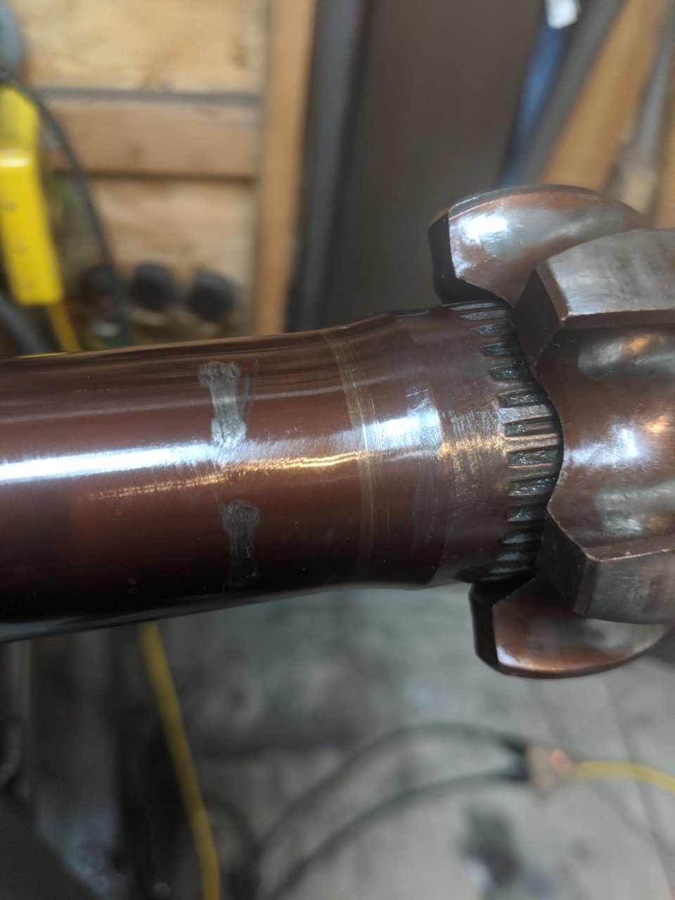

    The outer joint on RCVs doesn't really have any additional working angle due to the shaft being larger than stock. I attempted to get every inch of travel out of a +2 TC race kit and even before upper uniball would go into bind the birfield cup on the RCVs was hitting the shaft while turned due to the additional diameter. I ran it like that for a while until I had to disassemble one of the RCVs because it was partially seized and found the interference. The outer joints on RCVs are effectively identical to stock as far as the cup/bearings/cage/star, only differences are material, shaft diameter, and ability to disassemble them without cutting the shaft.
    Marks on the shaft are from the cup/shaft interference.
