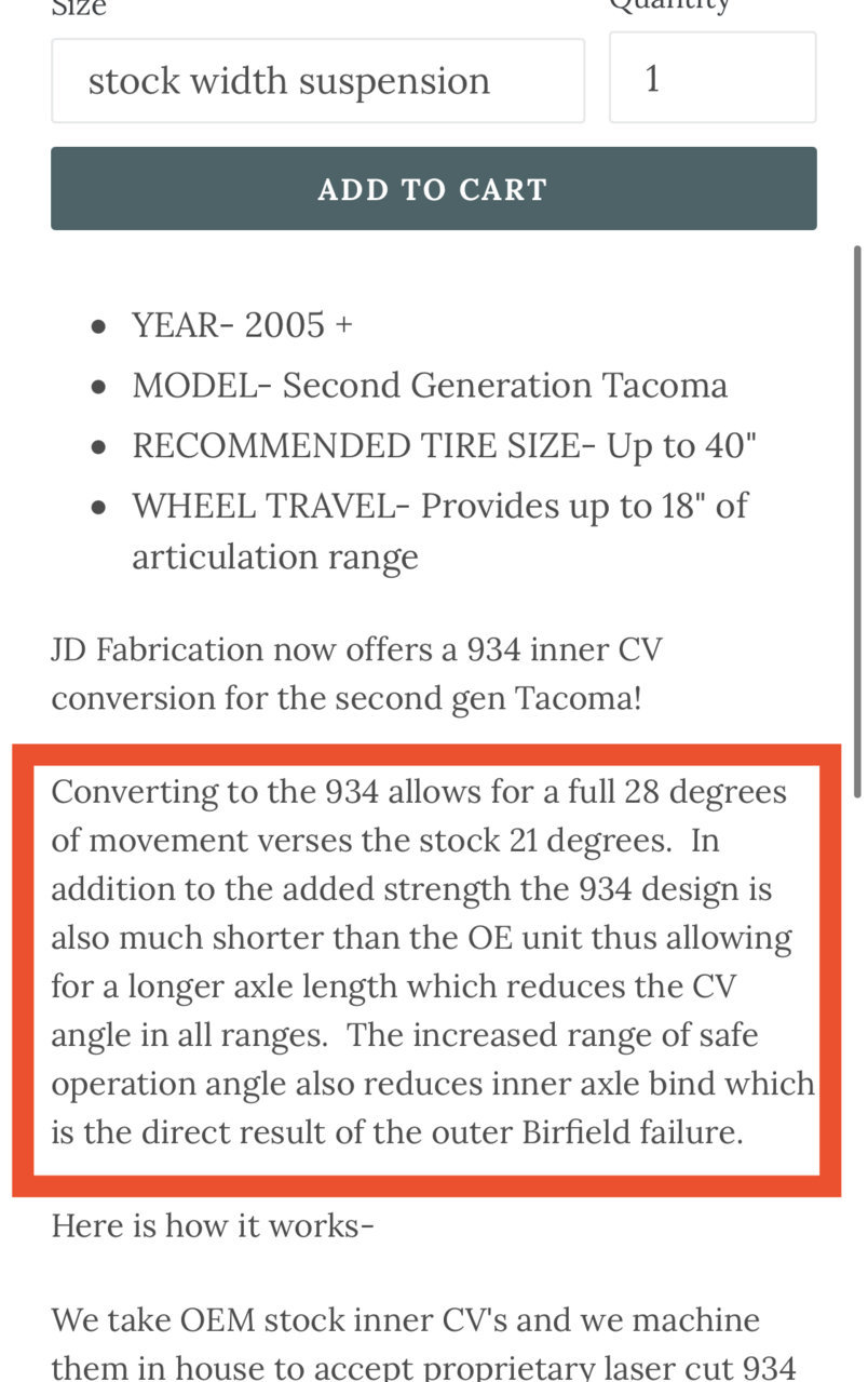

    I don’t think you understand why the others break in the first place... the OE others are very strong but when they are over extended they break... the 934’s eliminate the outer bind by running a longer axle with a true plunging CV. There is a reason why we went the 934 route and this is it. I’ve yet to see a person with 934’s have an outer fail

    I don’t understand, because during all of this talk it was never actually explained. Just lots of opinion over anything. I knew the 934 provided more droop but the outer stuff was never once mentioned or explained.

    Harry has said multiple times that they believe the reason the outers fail is due to binding on the inner, which is in fact addressed by the 934s. It's in his thread 1.6 million times.

    I didn’t realize you didn’t catch that before, that’s my bad. I did know that.
    Not to add fuel to the fire or anything but it is on the product page.

    Never once read it if I’m being 100% honest. I’ve read about all the rest of the parts, just not them apparently. So that is my bad. Either which way, it still could have been explained when the question came about. I apologize for my ignorance.
