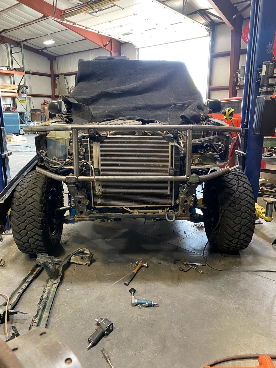

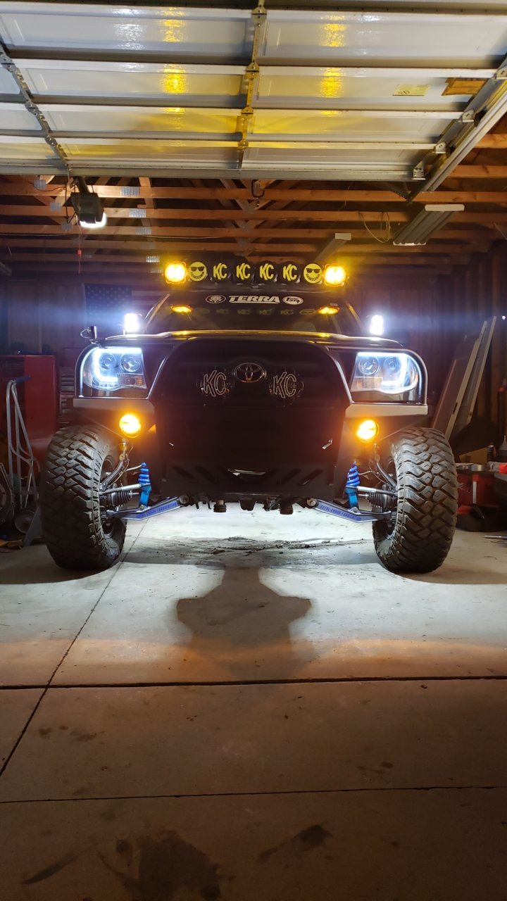

    Finally got my LT installed. The installation wasn't too bad. Now the truck is in a shop for bar work in the engine bay.20210825_215244.jpg IMG_0521.jpg

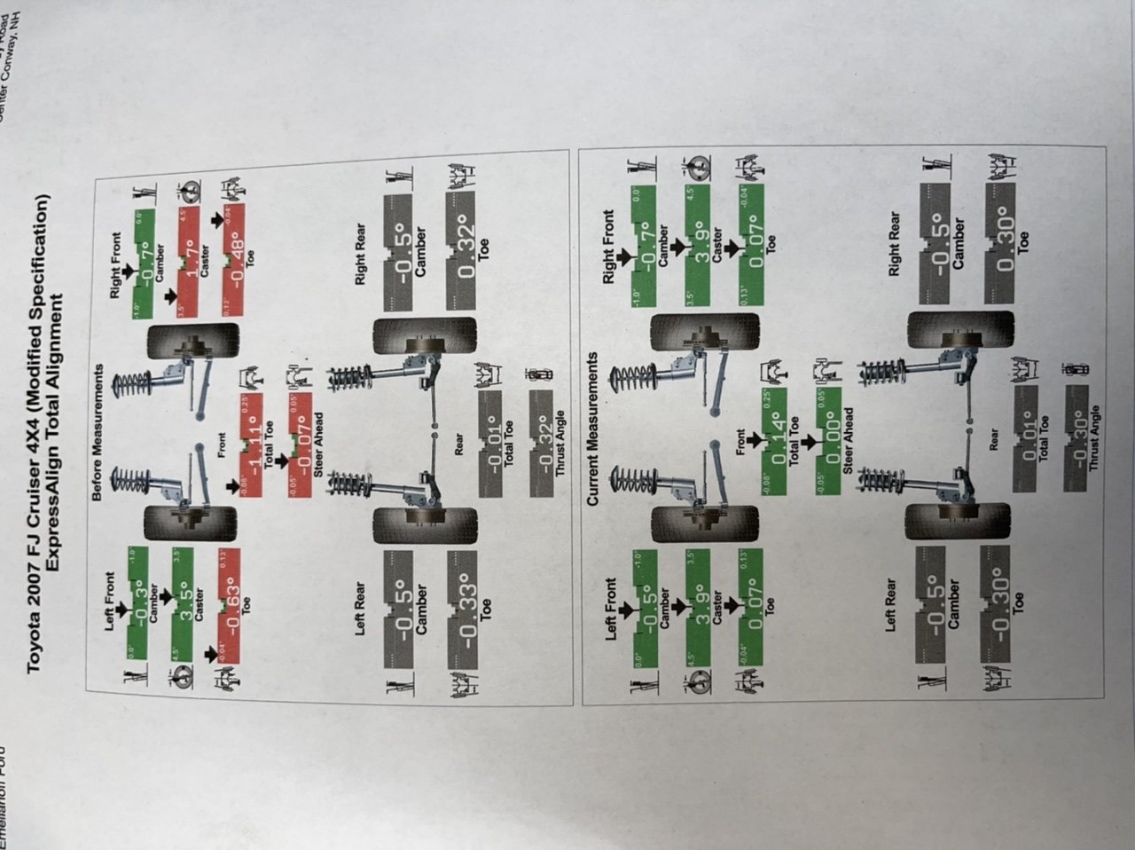

    Hey y’all. So I followed your advice for alignment specs on my FJ. Overall it feels WAY better going straight down the road, but it’s still not quite right. It gets darty in corners and especially under moderate/heavy braking. I have it set slightly toed in as was recommended, but I’m thinking I might want to go a bit more neutral for toe? What do you think?

    You have quite a bit of deviation between sides on caster, whats up with that?
    Whoops I was looking at the before.

    She was a bit fuckey before :laugh:

    Yeah I’d try straight toe and see if it affects anything. Do you have a warranty on that alignment? If you do you don’t run any risk of trying it and returning it after experimenting.
