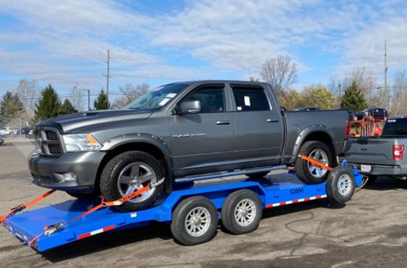

    Yes that’s right where I run mine

    That's scary.

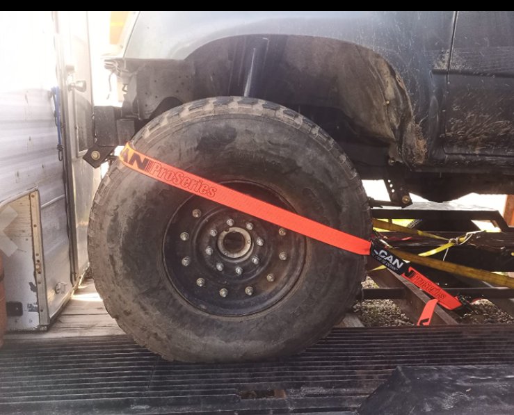

    Yeah, I don’t like it. But the straps themselves seem nice. I think up front I’ll just run it through my wheel like I showed earlier. Should be enough room but we’ll see.

    We have used the wheel through approach for my bosses track cars and it is much easier than trying to get underneath to a good anchor point. We traditionally do 2 straight straps and 2 crossed and have had no issues with car shifting or straps coming loose.

    That's what I was thinking. Easy and redundant.

    Be careful going through the wheel, if your beadlock rings are rock rashed they will eat through the strap. Ive thrown away a few straps because of this.

    That’s a good point, thanks. Mine are nice and fucked up. LCA it is.

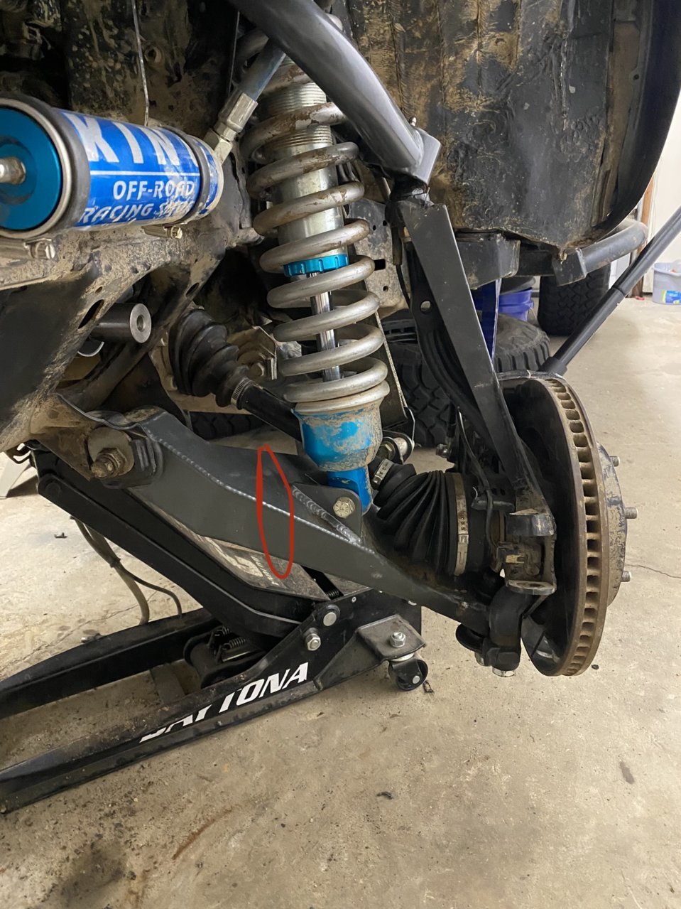

    I tie them down there every time... works best for the taco and then around the axle in the rear

    yup same around the inside of the lca and never had an issue and I’ve towed it about 4000 miles that way.
