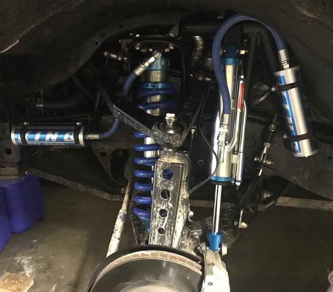

    It’s been a while since I’ve talked about this sort of thing and can’t remember the terminology of the layout so here’s a pic of the front and rear.

    those are staggered which are different from @Airdog
    the bump zone will be similar with equal valving but the other comp zones will not be.

    Ah that’s good to know. I was worried his was fine and mine isn’t so I might not be simple valving to help.

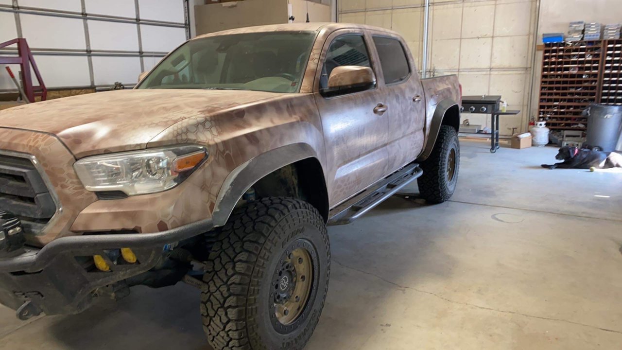

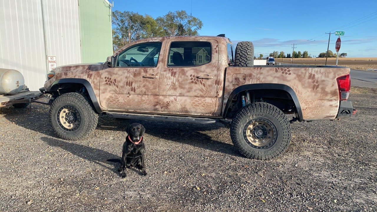

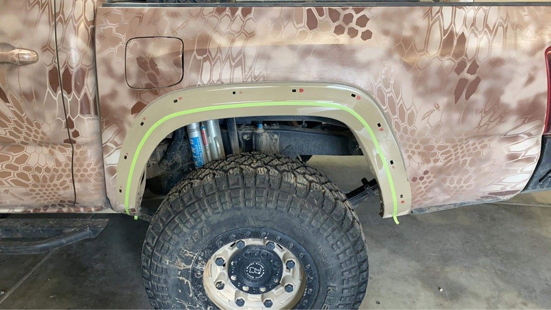

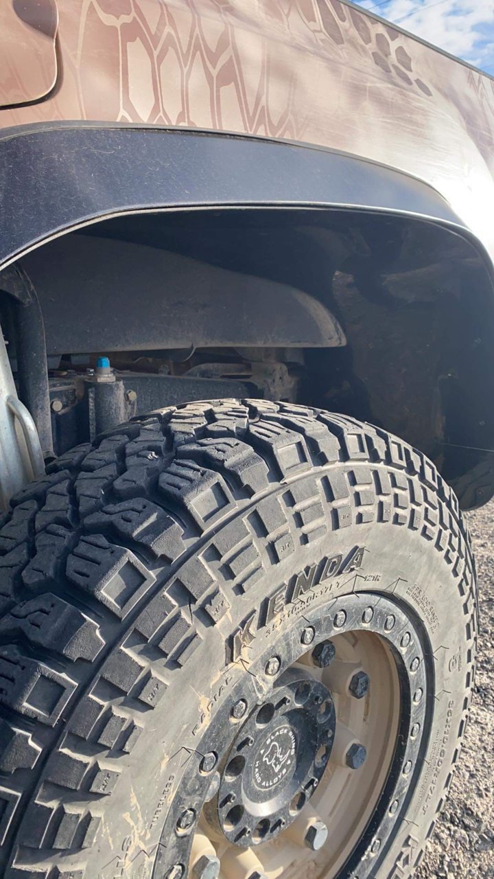

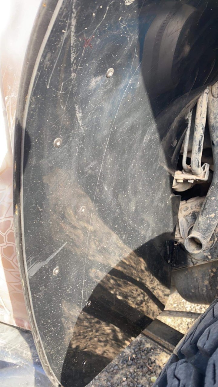

    Been a bit since I have been here, couldnt watch all the great stuff you guys were doing anymore. The below is my effort to avoid Glass and was 100% done by a friend. Cant claim anything more than an idea he took to action. Issue originally was my +2 didnt have fender coverage resulting in muddy windshield springs and open tire rock throwing (even broke my side mirror throwing one up off the rear). 2nd issue was I hadnt done the fender cut yet to get that little bit extra clearance for travel and maybe chains. Ed pulled it off with mockup, CNC cut to match mockup pieces and then tig weld, mount and finish. I would estimate the final extra width is ~1.5-2" of flare and we moved up ~2-2.5" with the fender trim and ABS liners. Can't claim any bit of the work, but I'm happy with it and thats what counts and I think Ed is happy with it. Still havent' gotten the bill yet though........
    Ed took and sent all the photos; I'm still overseas working.
