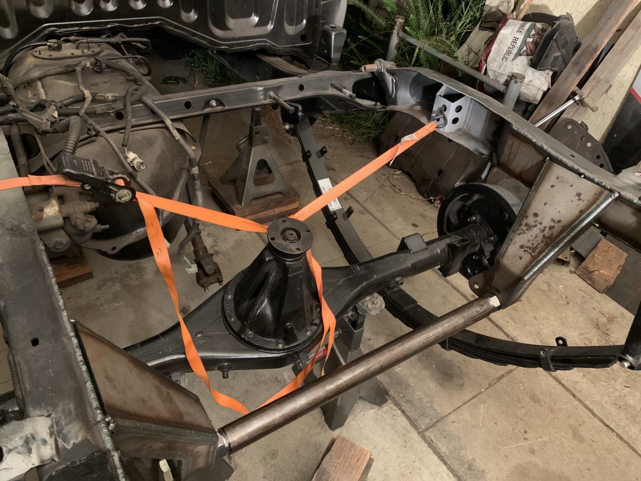

    Probably gonna have to build something yourself. Or do a u bolt delete

    Here's the axle he's talking about - SUA ruff stuff perches are welded on there and set up for an extended cab or double cab pinion angle for H70's / E30's welded by @Anthony250 taken from measurements off of his truck :notsure:
    At this point all that's needed are u bolts and a pair of u bolt plates. I recommend DMZ or Ruff Stuff (I had DMZ but went with RS due to bigger u-bolts). Deaver sells U-bolts but I sold him the U-bolts Deaver gave me with my springs with the axle and they had 0 miles, just a bit of surface rust that any u bolts will get if they're not painted and will come off with a wire wheel easily.

    I’ll just get a plate and reuse the ubolts you tossed me with the axle.

    2nd gen taco kit should work, aren't they the same?

    I think the axle is larger in diameter for the tundra axle, as well as the springs are narrower for the Tacoma leaves vs a full-size truck.

    I believe he is using a first gen tundra axle; not the 10.5".

    Yeah completely different ^^^
