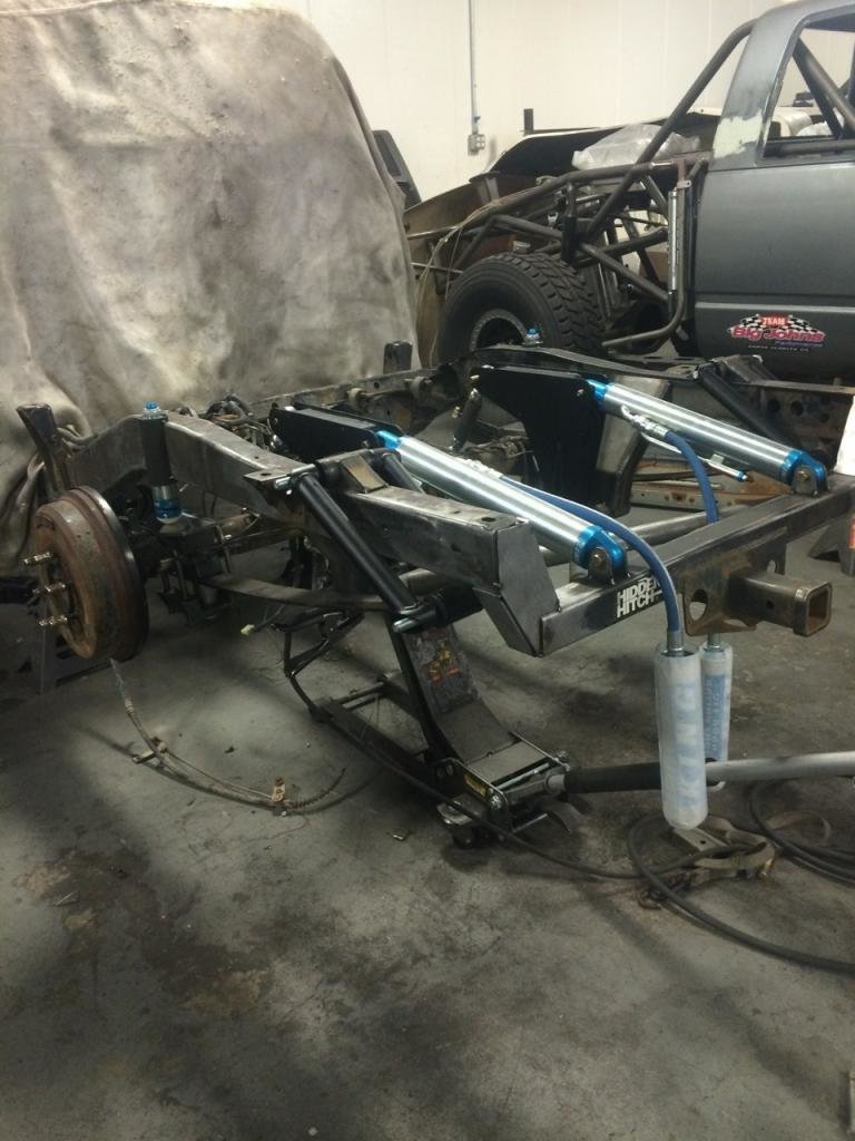

    I was going to do this but ended up making my own rear cross member and hitch:

    nice. and you are running 63's?
    Ive wanted to go canti for so long but my math skills arent great for figuring it out. I hit up a couple people to get some tips and think I might have an idea on the pivot boxes, but the rest would have to be trail and error. I have a cnc plasma to cut it all, but metal aint cheap right now, especially if I mess it up.
    Option two is to fab my own hitch bracket like before, bolt on is just easier these days
