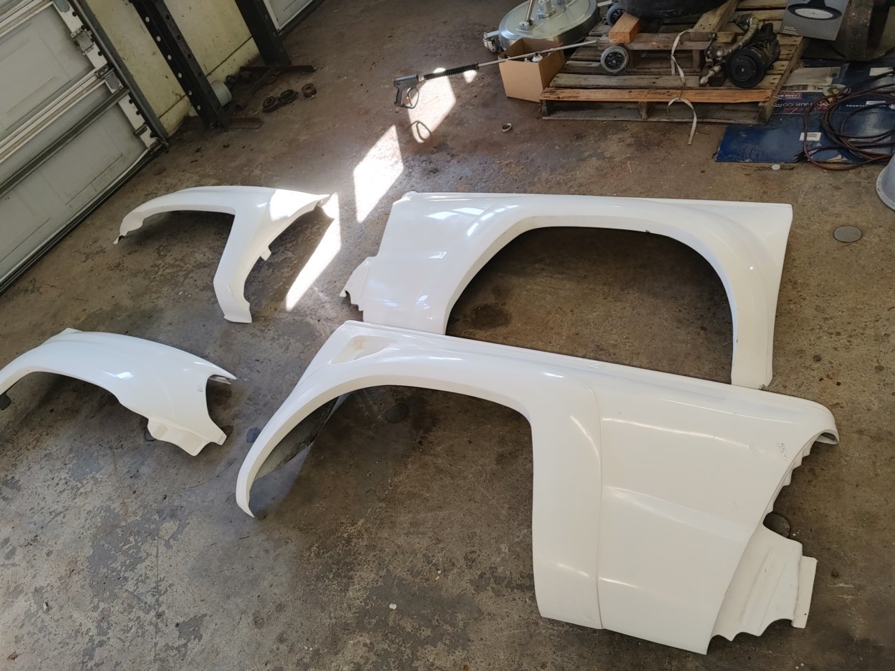

    Thinking about pulling the trigger on the +2 McNeil fiberglass.. I’m not LT May do it down the road. Once the kids are grown.
    just wanna know you long travel guys experience with McNeil? .. seems hit or miss..

    Mine fit pretty good. didn't really spend a ton of time or effort on getting them perfect though since i knew i was gonna hammer them pretty good. just recently trimmed two inches out of them and actually really like the look of them. But since going to 35's and +3.5 i just don't like how much tire i have sticking out. Only downside to them i will say is they aren't the thickest layup. compared to the new adv i have to put on the mcneils are like half the weight.

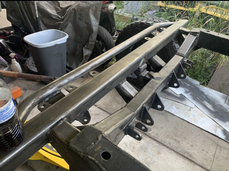

    My original thought when I rebuilt the rear frame was to possibly build in two "receivers" so I could slide in/bolt in different bumpers if I ever wanted to change it up.
    The last 18-24" is all heavy rectangle tubing, twice as thick walled as stock frame. Shackles are above the frame now. Other option would be going to 9" shackles under too I guess.

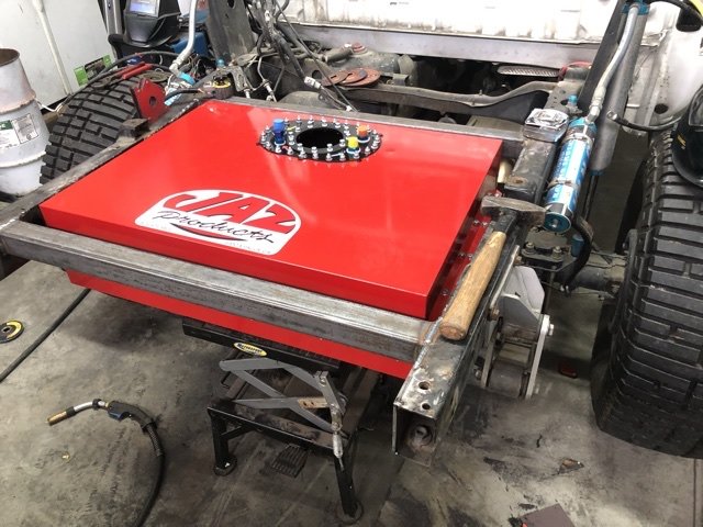

    Getting the truck prepped for eventually getting my DD 4 link installed. Fuel cell install is the first on the list.
