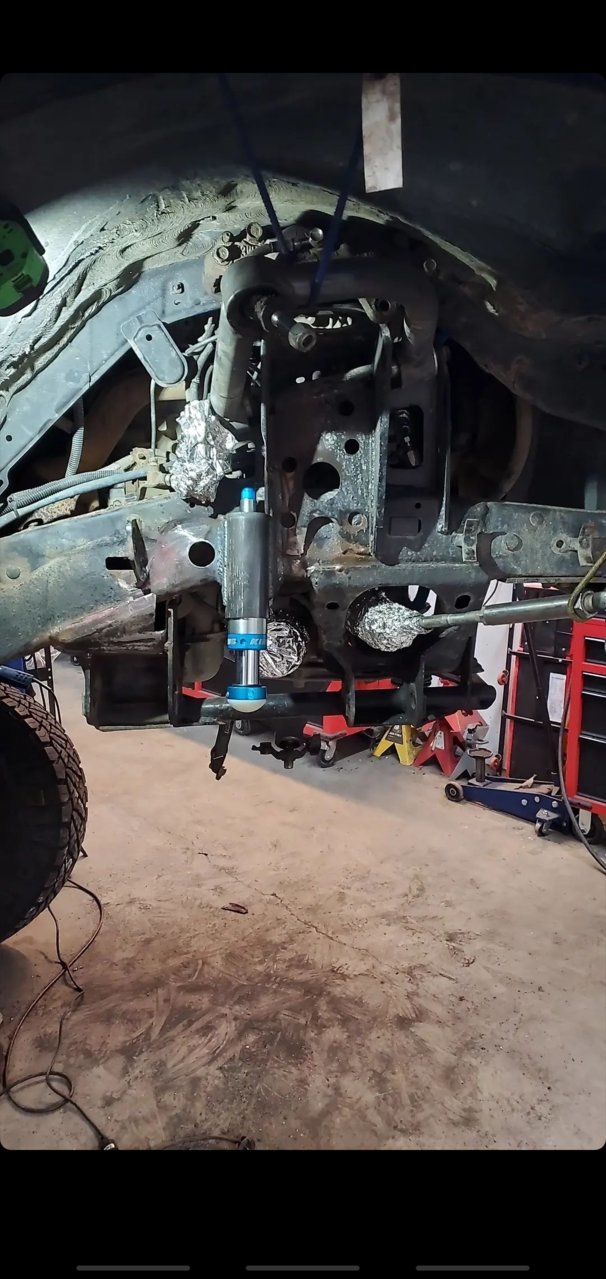

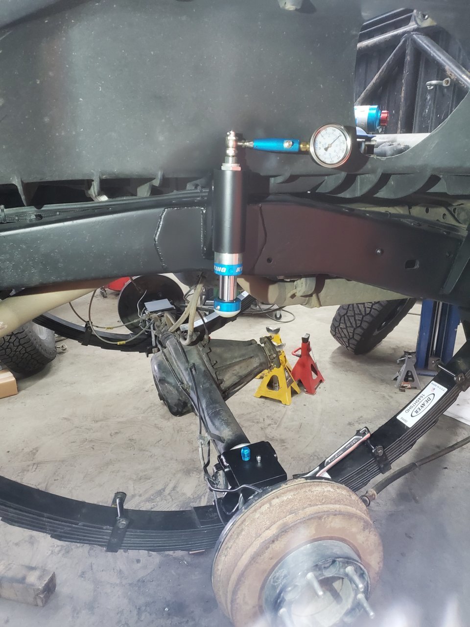

    Just wondering if anybody can tell me if some 1.5" .120 tube is fine to space my king 2.0 bumps down to 1"?
    Just got them mounted up, but want to shorten them before bolting everything on and I've never taken apart a bump before. Looks the same as shocks from what I can tell?
    Also, what pressures are you guys running front and rear? Just want a good baseline starting point. I'm a hydrobump virgin

    Think he is talking about shortening the stroke of the bump. Shorter bump stroke/zone is nice for IFS up front since there isn’t a lot of shock travel to work with. Leaves more room outside the bump zone to tune with a bypass. Good info though.

    Honestly, if you’re not running bypasses I’m not sure I would space them down. You’re going to want a decent bump zone in my honest opinion.

    I believe I used some 1.5” schedule 40 pvc when I shortened my rears. Whatever slipped over the shaft nicely. The pvc is plenty strong for that application and won’t scratch the shaft. As for pressure, I’m running 85psi in my rears and have yet to fully bottom out since reworking my geometry.

    I spaced my fronts down to 1” as well. Using 1.5x.120 worked fine. And 200 psi. No bypasses yet

    Thanks! I did read that link as well, but 300 psi seemed extremely high. I only have a big nitrogen bottle for my shop so was hoping to get a closer baseline before packing this big bottle out somewhere haha
    Even just a 1" bump off the LCA will be probably 3" of travel at the wheel in the bump zone. I haven't sat it down at ride height with the bumps in yet, but I'm guessing I would be pretty much riding on them at 2".
    Perfect. I have a tonne of cut off chunks of tube but no PVC, but that's good to know for sure. If I find some I'll use that. I'll maybe start at 110psi then and I can drop it down a little if necessary

    Got the bumps shortened down to 1" in the front with 200psi like @Bobotaco and put my rears to 90psi cuz I think I typically run a bit more weight in the back than @snowsk8air2 . Easy enough to change pressures later though. Stoked to get them shortened though!

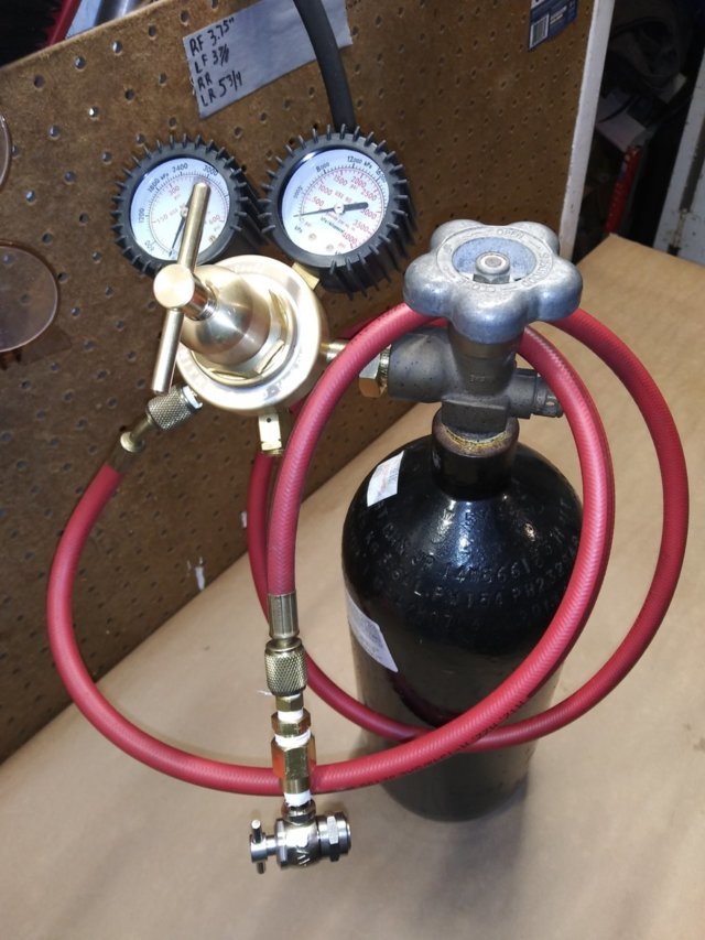

    Yea after reading what psi everyone else settled on, 350 to 400 must be a general starting point for a full size.
    I put this little rig together a couple years ago, I'd loan it to you if I didnt live 3k miles away.

    Thanks!! I do have a similar setup, it's just a full size bottle. I think after a couple time out I should be able to get it close. I could also use my compressor up to 150psi to tune, then just match the pressure with nitrogen when I get back
