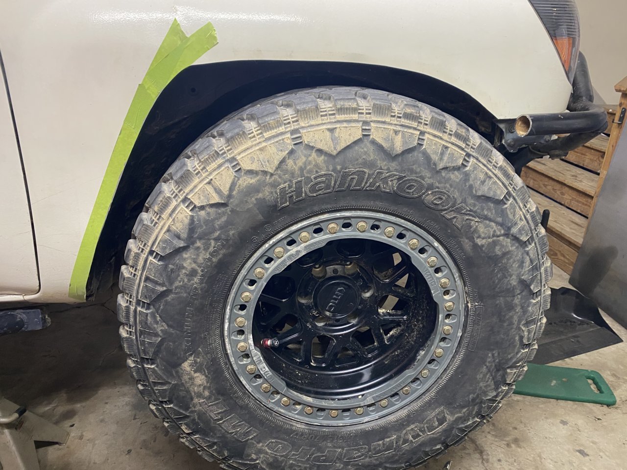

    Guess it just depends on the kit being used. I have the JD 2.25 and at full bump (metal on metal uniball contact meaning type of bump stop doesn’t matter) my 35 doesn’t contact the upper fender. Just a little bit behind the headlight but that was easy to do a little tubbing there.
    Not saying the HC fenders aren’t worth it because they also strengthen the front end a lot, but it’s just a lot of cheddar to drop.

    Pics to back up what I’m talking about. This is uniball metal contact and you can sorta make out the inner fender in the shadows. This is with a 3.5” back space wheel so maybe that comes into play because the tire just sticks out so far from the body lol

    That's what's interesting. We have the same kit and I'm currently rubbing the inner fender at full stuff with OE bumps. I have a few inches of shaft left on the shock when I bump out but I didn't notate how much more I could get out of my upper uniball. Something I'll have to notate when I get the opportunity.
    I've got 4.3" backspacing so that may play a slight roll.

    Yeah when I cycled, I pulled bumps and coil off of the coilover and maxed out the upper uniball and cleared lock to lock. I’d already tubbed for 35s stock width so I just had to do a little more trimming up front behind the headlight since this is .875” forward as you know. I did have about 1.5” shaft remaining at uniball maxed out.
    Edit: but my stock width tubbing didn’t involve touching the inner fenders except a small area behind the headlight. And the firewall obviously.
