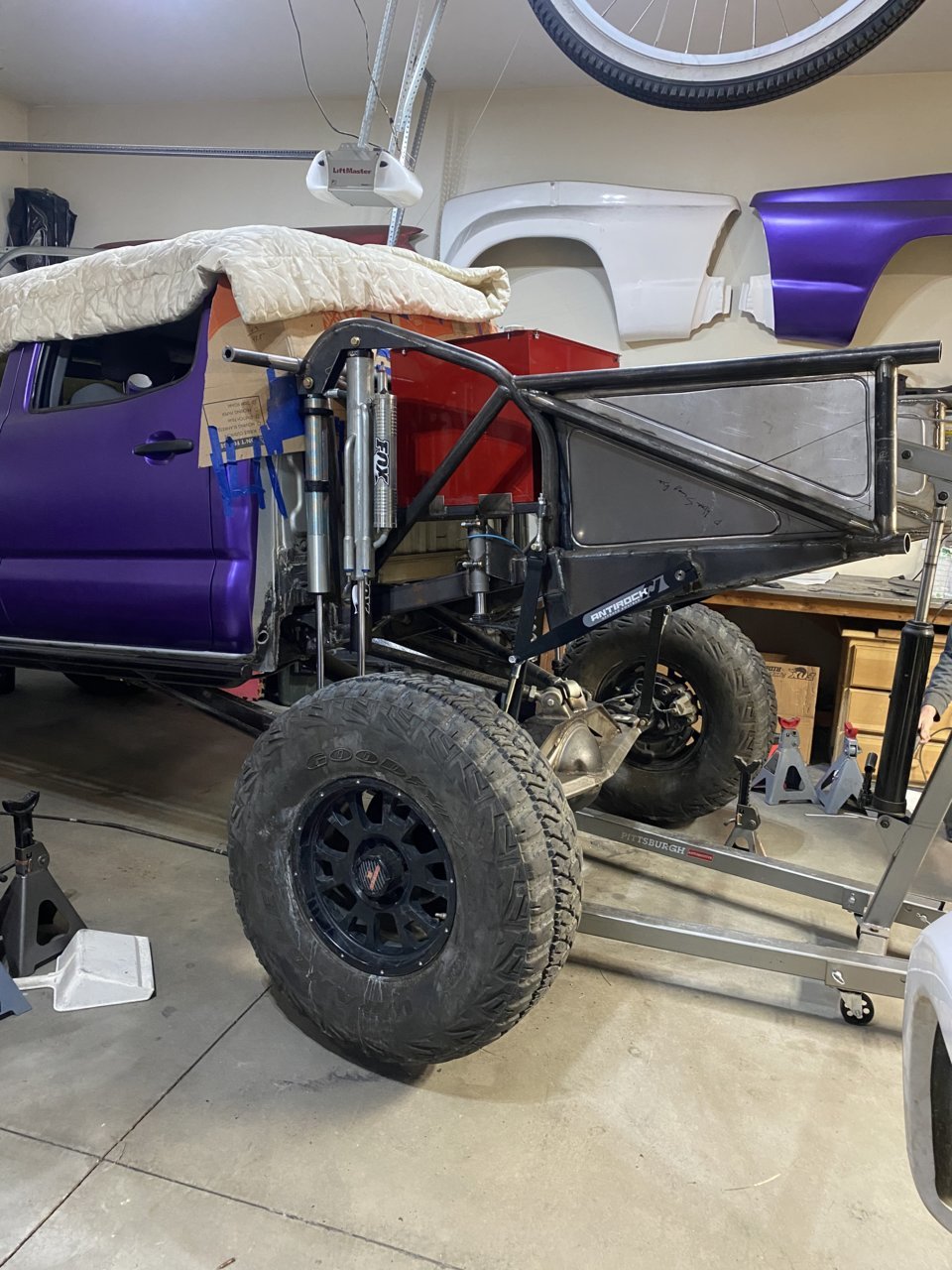

    E47A145C-0894-4DC1-9E9F-F039FD0B6BBC.jpg C987EFC6-90BA-4688-895B-FBF139A968A9.jpg BDC915F6-F1C8-467B-933B-B07EF81B3F23.jpg

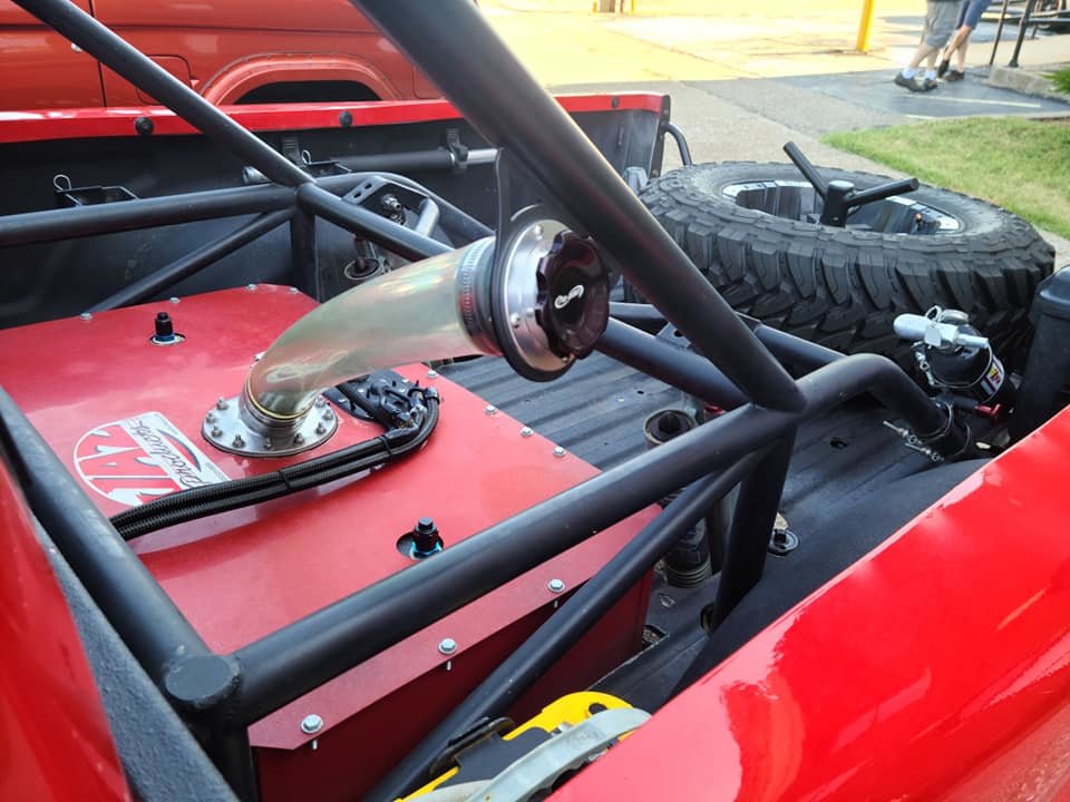

    I picked up an RCI 2191A fuel cell. Is it possible to use the factory pump in the filler neck location and I guess tap a new hole for the filler? Also looking at Motobilt’s cell for the Jeeps stock pump and their flange is 6” as well and appears it would work with the taco pump right out of the box. Kinda clueless with the fuel cell stuff and not trying to reinvent the wheel. Would love to keep the factory gas gauge, but not concerned with evap unless it’s an easy addition.

    I just cut a new hole for the stock pump stuff. mine has been that way about ten years and works great. I think there is more pics in my build thread
