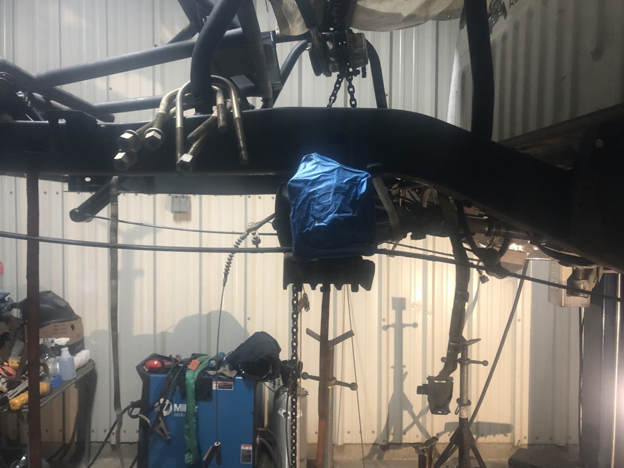

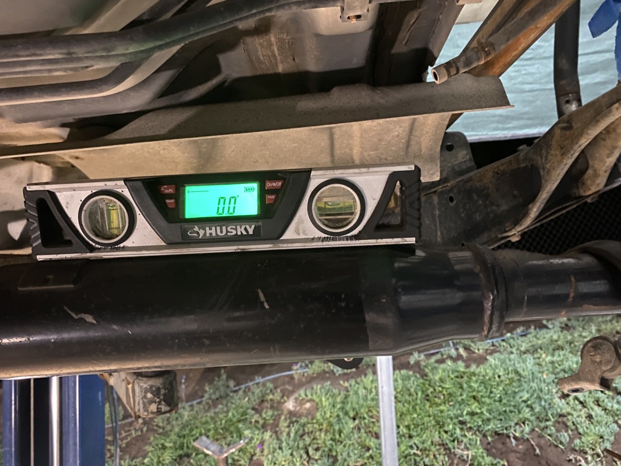

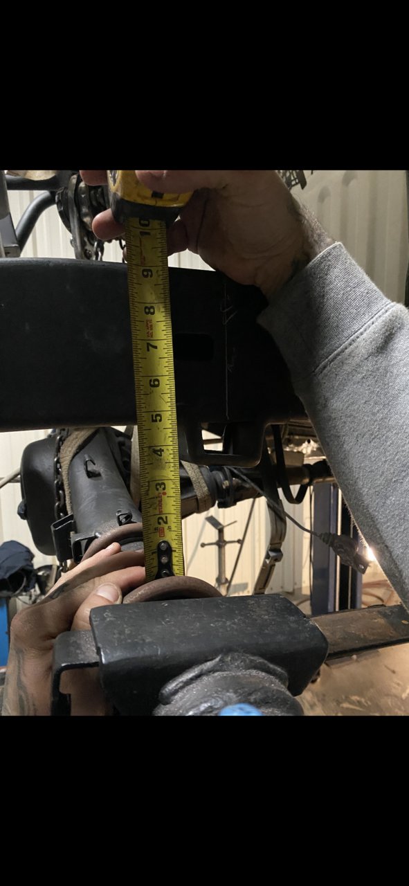

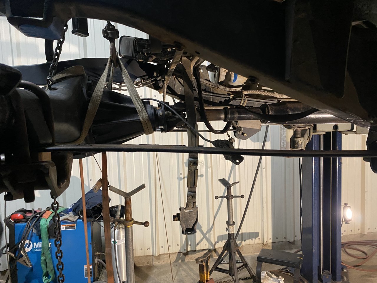

    Need input on full bump cycling on SUA.
    I’m scared to force the drive shaft into a negative degree figuring my bump stops.
    Someone said don’t be afraid to get the axle close to the frame at full bump but last night I was at ~4.5” from the bottom of the frame with the driveshaft at 0°.
    someone said they lost quite a bit of up travel bumping where I’m at now and ended up redoing it and got much better results.
    thoughts on pushing the driveshaft negative?
    A0DDD8FB-A232-4240-9E63-33E45F1F600B.jpg 26BB8555-2300-4562-A532-4ABCACE0324E.jpg 710CBF39-9383-4DD2-B2DB-DC919A36F5F0.jpg
    if I push it further the main leaf gets a little negative curve and the driveshaft also exceeds 0 degrees.

    Maybe this is just me being uneducated on the matter, but why would it matter if your driveshaft is “negative” when just driving around town your driveshaft is living at a substantial angle?

    the farther negative I push the farther the shaft slides into the slip yoke. I don’t want the driveline to bind negative on a hard hit if I don’t bump proir to the splines going too far

    Bump it as high as you can...going"negative" isn't going to hurt anything u joint wise. When at your desired bump...pop the diffside of the driveshaft off and see if it's bottoming out(which is bad)....and if it is...you can get the driveshaft shortened not a big deal
