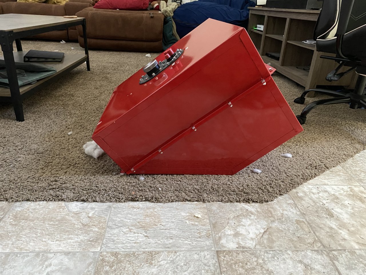

    If hose is all I need, I have plenty of that at the shop. Just trying to get all my ducks in a row so I don't hit a snag 3/4 of the way through.

    that’s all you need and ultimately since you have the facility that you do you should drop your tank and run all new full length instead of patching or extending existing. you dont have to drop the whole tank just drop the inside ( it hinges at the frame side ) and there is enough to get in there

    Yeah, I'll be dropping the tank anyways to box the frame. Just wasn't sure if the tube portion of the neck had to be messed with at all or if it was just hose.

    personally i like to chop the metal tubes short and use flexible hose the whole way just because you have more ( literal ) flexibility for getting it as high and forward as possible. I had some left over dei titanium exhaust wrap so i wrapped them into one bundle for a little protection from rocks etc

    cut it closer to the tank, that way what's hanging in the fender is metal. the breather and return are less critical and had to be lengthened the most.

    Pretty sure that when you cycle your suspension to full articulation in the rear ( assuming 35’s ) you are going to find that the tire will occupy a whole lot more real estate than you think. In the rear your inner fenders you want to build will just be a couple of skirts not a full liner. If I left my OE filler neck metal portion in tact my tire would dry hump it like a 12 year old that just discovered PornHub, I had to chop it short to be able to tuck the hoses away from the tire.
