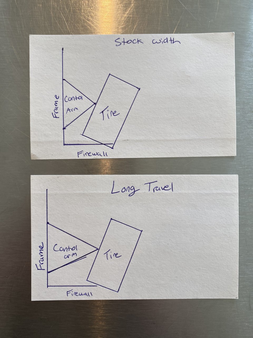

    Question in regards to caster and long travel...
    What type of caster can you get with a 3.5 kit? Does caster even matter at that point anymore?
    When the front wheels are pushed put that far does it amplify clearance issues with cab mount?

    Because the pivot point is being pushed outwards it actually helps clearance with the cab mount/firewall rather than hurt it. This is a roughly to scale drawing of a birds eye view to help you visualize it.

  16. Jan 27, 2022 at 6:07 AM
    IvanhoeTaco
    IvanhoeTaco Well-Known Member
    Aug 4, 2019
    #301199
    2,943
    Eastern NC
    2005 Supercharged Converted Prerunner
    Total Chaos 3.5 LT, King Coilovers, 35x11.5r17 on Falcon T2, ADV 4 inch fiberglass, 4.88 gears, FJ cruiser transfer case, 4 runner front diff, Cab mount relocate, archive hangers, shackles, king 2.5x14 rear shocks, icon rxt leaf springs, king hydro bumps
    Makes perfect sense. Thanks for the illustration. Do you have to settle for stock caster numbers with these kits?
