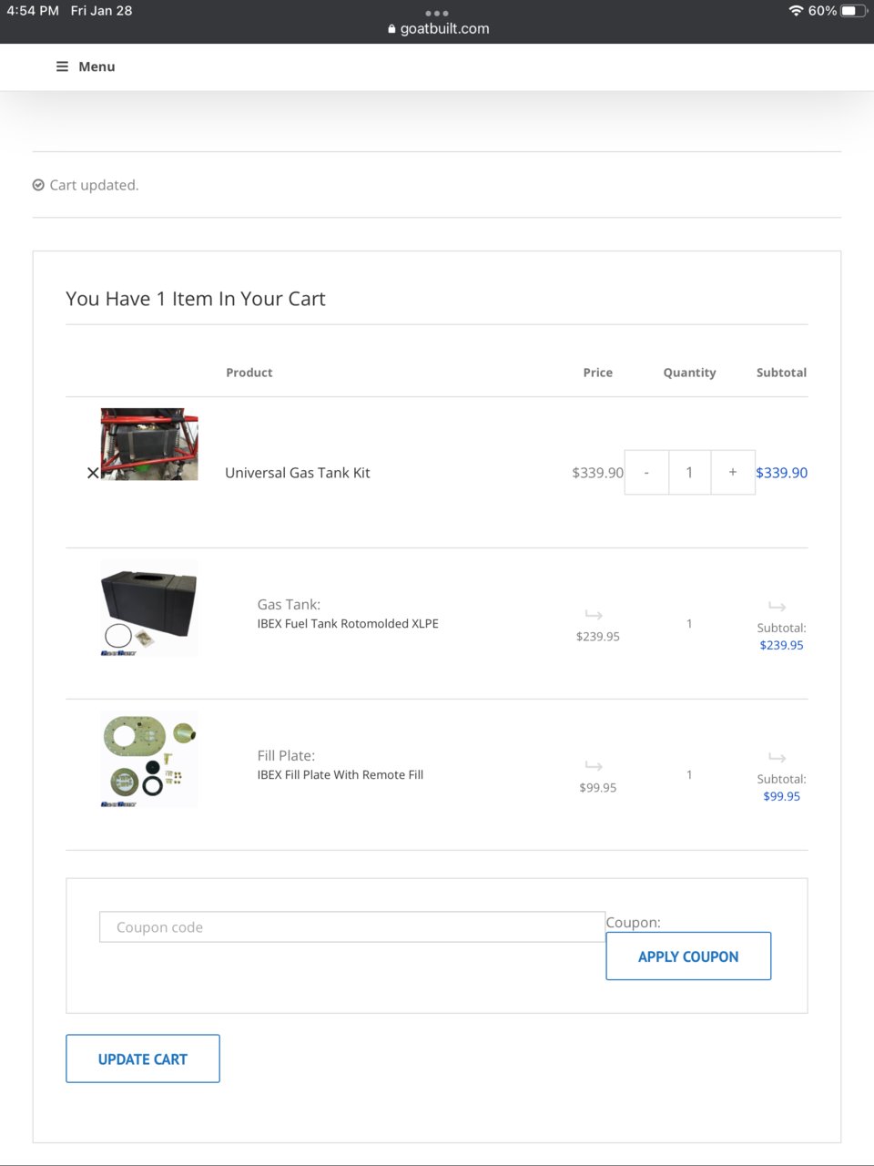

    Whose running a fuel cell? Getting ready to redo my bed and order an ibex fuel cell with a Gm fuel pump assembly. Looking at running all new lines to the motor. Anyone know what kind of fitting I need to plumb in new lines? I can get the gm to -6 push connect fittings and looking for the same thing on the toyota end. Motors a 3.4

    https://www.kartek.com/parts/fragol...ized-aluminum-an-metric-adapter-fittings.html
    Don't order before you measure - these are good. Others were too long and wouldn't seal with only a crush washer. All Toyota fittings are 14x1.5mm - you may have male and female depending on your year.

    So the 14x1.5mm is the correct fitting for the engine side? Whether it’s a male or female fitting?
