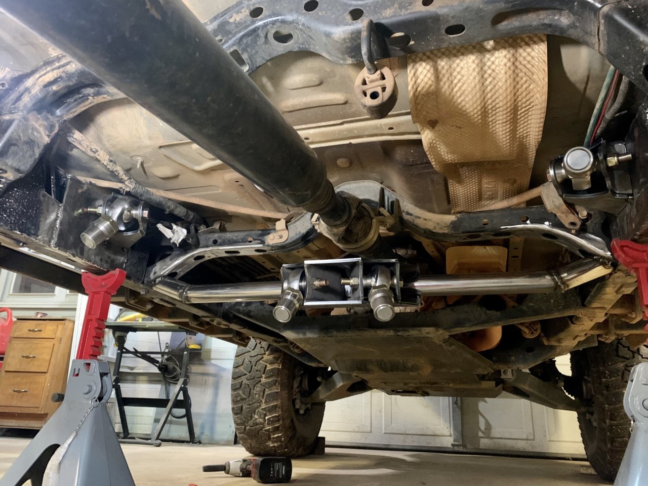

    Here’s where I am on my dual triangles. Should be cycling things soon, but first impressions the heims will not be the limiting factors and links will clear the frame. Starting to come together a bit.

    do not tie into that oe cross member in any way it is weak AF and it will literally tear…ask me how I know. get rid of it and box your frame to have something solid to tie into.

    I saw the pic and was like “he should tie into that crossmember because that’s a large unsupported span of tube” but kept my mouth shut. Glad I did :laugh:

    It’s getting triangulated to the frame up front and the lower link brackets. It’s definitely not strong enough on it’s own.

    I may plate the crossmember and tie into it, but mostly to strengthen the cb crossmember not the other way around.

    The links shouldn't be load bearing. They are primarily a pivot point. Or am not fully understanding the load forces that we're looking at?

    More forces in the horizontal plane from torque at the axle and hitting bumps (trying to pull the lower links back and push the uppers forward). The biggest stress in the vertical would be smashing rocks. That’s how I understand it at least. Might learn otherwise.

    There is a whole lot of load going through the links. Using front factory leaf spring mounts (like I've seen somebody do very recently) will tear clean out of the mount and off the frame.
    Here is the estimated loads from my truck: Upper link 14K pounds and lower 19K pounds.
