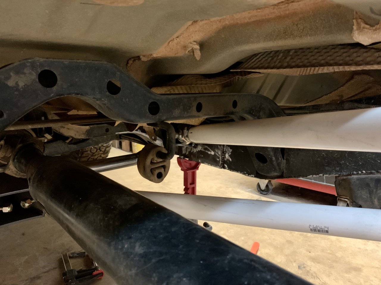

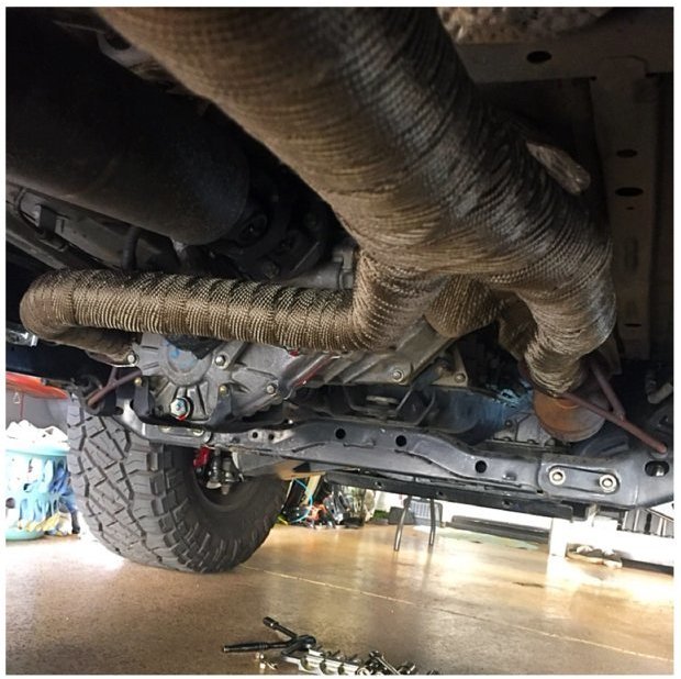

    I’ll have a better picture soon when I put the pvc links in to cycle it. I may have to turn it down right under the cab, but I worry about fumes from going slow and being parked. I may have a small window to put it in between the links and run to the rear. I like having the lowers inboard and tucked away, but can definitely see the merits of trailing arms and single triangulated now haha

    Got my new white composite links made :rofl:everything cycled great almost like I planned it. still need to stuff each side individually, but it’s dinner time.

    One suggestion. Take and gusset the link mounts especially the upper link mounts almost making a truss of sorts for the rear. Also gusset the link mounts as much as you can where they attach to the frame. Looking really good so far!

    Thanks man. I’m planning to do square tube on the upper axle side bracket and the frame side links will be connected with tube and gusseted down the frame. Just gotta make sure this set up is Gucci and I’ll burn it all in. Gonna sit on it until the weekend and really cycle everything

    Get a magnetic angle gauge and watch the pinion angle through suspension travel.
