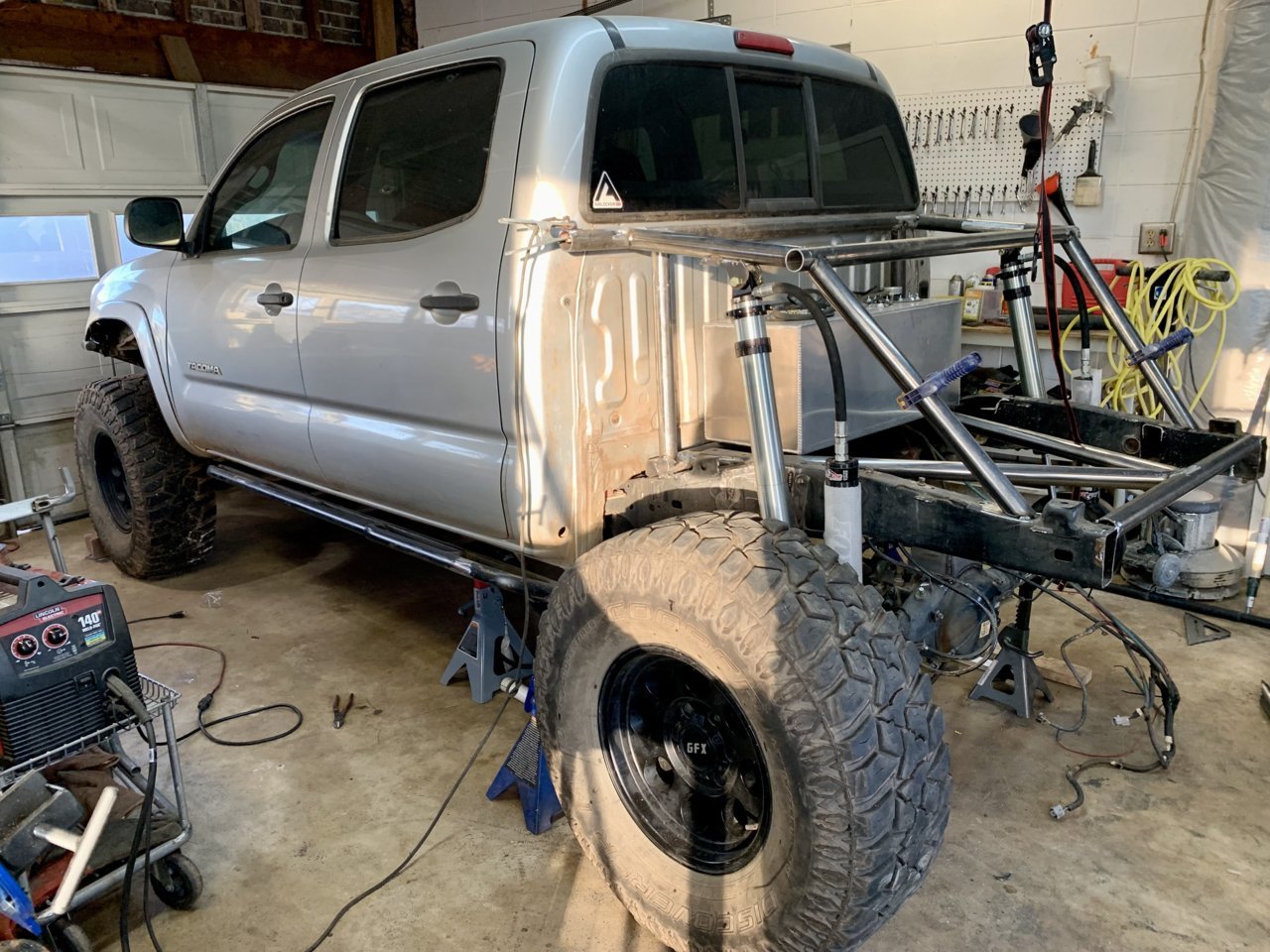

    You should notch or step your frame to move those CO’s inward because your articulation is going to be very limited by your tire dry humping your CO like a 12 year old that just discovered Porn Hub. Your more into trails and rocks right ?

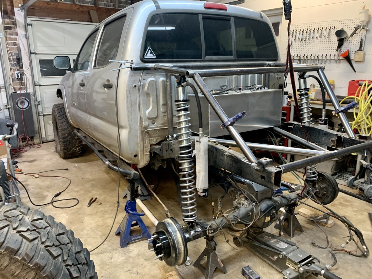

    It clears the tires fine, but the coil will contact the factory bump pad at full tilt so it’s getting cut out and maybe notched if need be. I set it up with 1.5” spacers even though I’m using 2” so I would leave myself enough room just in case. I was surprised how much clearance there was. I thought I was going to have to ditch the frame. Yes, not a lot of fast stuff here.

    I’m really confused because my tire rubs my bed when it is stuffed and you a coilover in that space so how is the tire not hitting the CO ? Are you letting the opposite side droop out fully or are you just jacking up the side you are checking ?

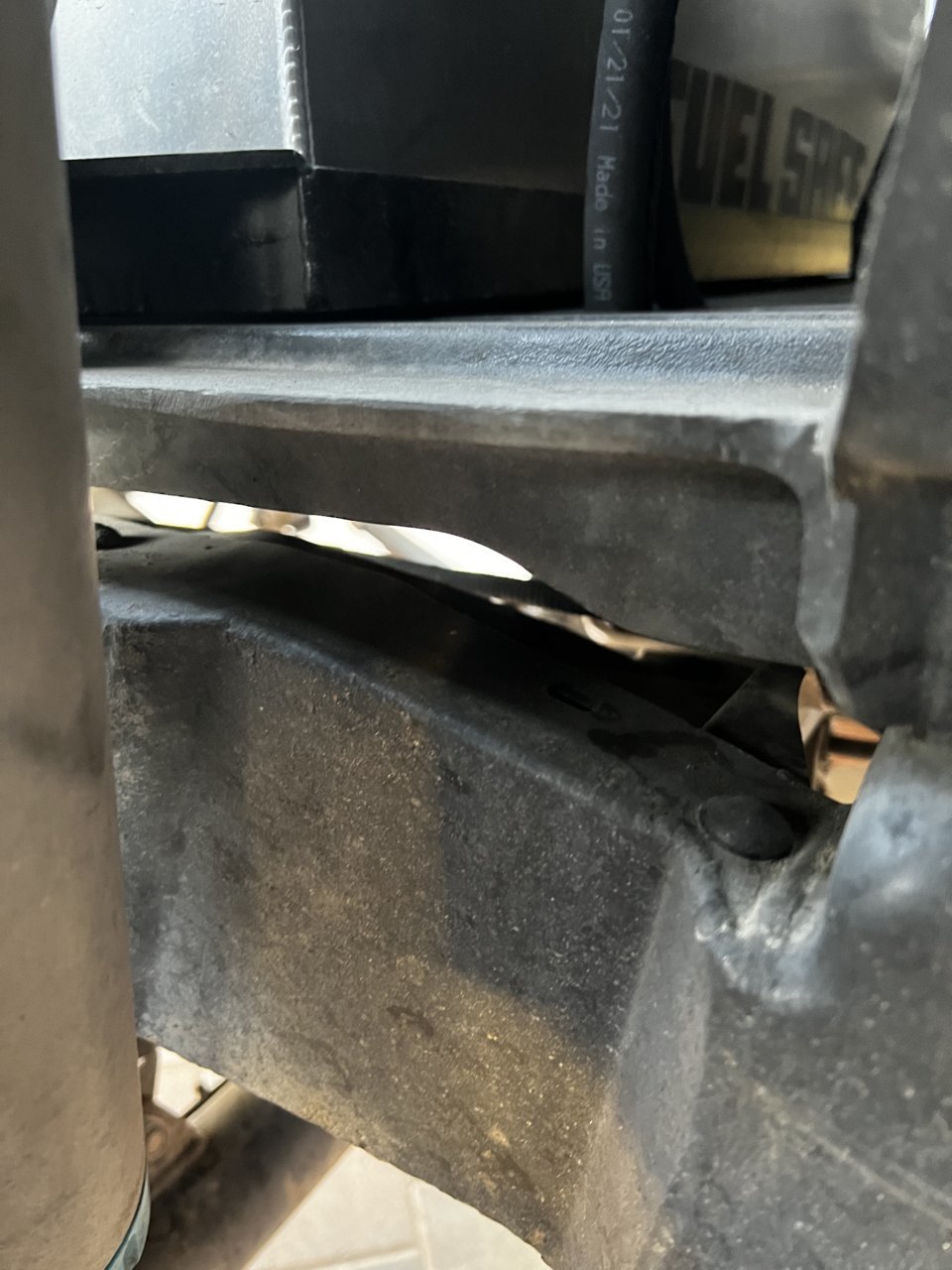

    Mine is mounted to the axle tube not a trailing arm so maybe the frame taper is playing a part. Im 2” from the spring perch. Im also running 125/150 coils which may be thinner than yours? I’m further away from the tire than the frame. I’ll have to cut at least the bump pad though. This isn’t much more helpful, but here’s another pic

    Got any photos of it articulated? You're getting quizzed on it because every person that tries to do it like you have, have to notch the frame and angle the COs in at the bed cage to get full performance....and your COs are like 6 inches away from the frame?

    The shock body is 2” from the frame at full extension. Not sure where you’re getting 6” from. I’ve said I will likely have to notch the frame where the bump pad is. It would probably help to note that I’m setting up for 5.5” of bump. It’s not the end of the world to move the mount either, and it will be cycled again as I notch what needs to be. I’ll take pictures then.

    Definitely hitting the coils haha. I wasn’t fully drooped on the right side when I cycled it. Easy fix though. Good looking out.
