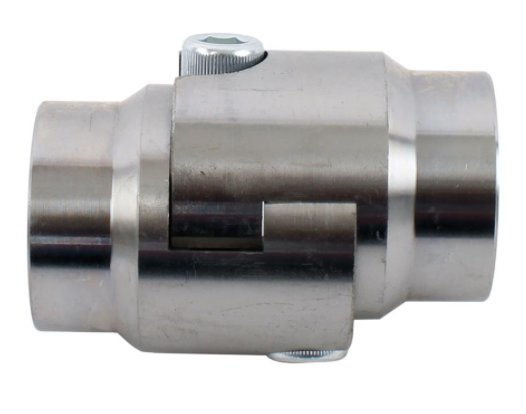

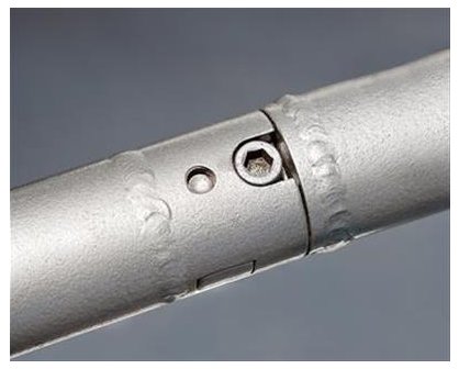

    Yes
    Use tube couplers , makes no sense to have to cut a tube to remove a serviceable part. I used this style on my bed cage so I would still be able to remove my bed if needed
    https://www.summitracing.com/parts/...-jX8KHT31XM4kXgA5puil0XgVKzkWJRcaAgo_EALw_wcB

    I used those and pin/socket style on my tractor (removable guard on front to protect hydraulic pump) and on the roll cage of my '40 (removable front bars to have easier access to engine). They work well, remember to orient them so the machined faces take potential stress and not the bolts.
