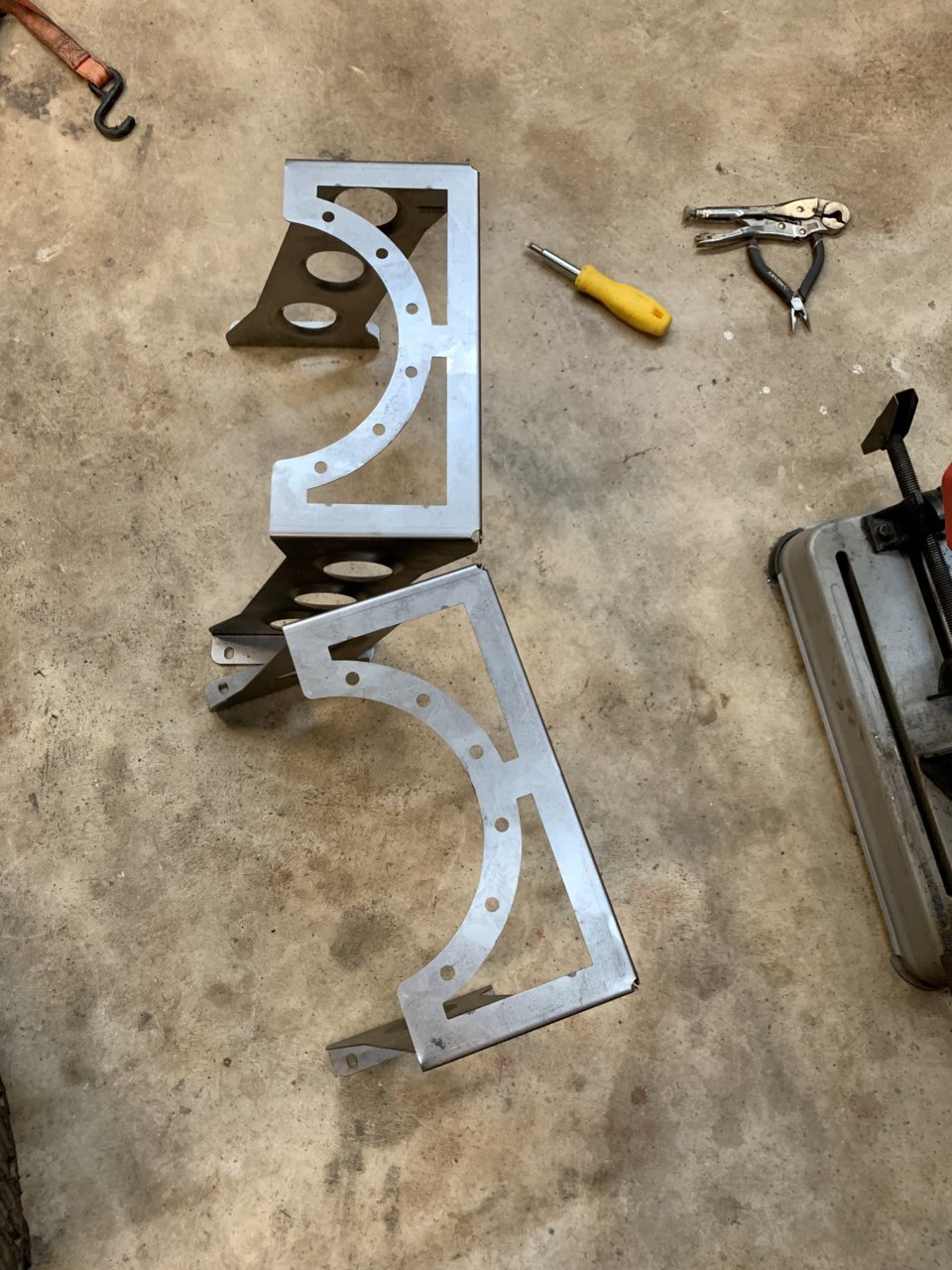

    Ok so yeah just have anything built above that be removable but most guys keep the main structure wider than the fuel cell so it lifts out vertically or put anything above it on tube clamps like shown. You could also build a bolt on structure above it using delrin bushings and / or solid mounts if you’re still getting used to welding as tube clamps won’t like deflection in your setup.

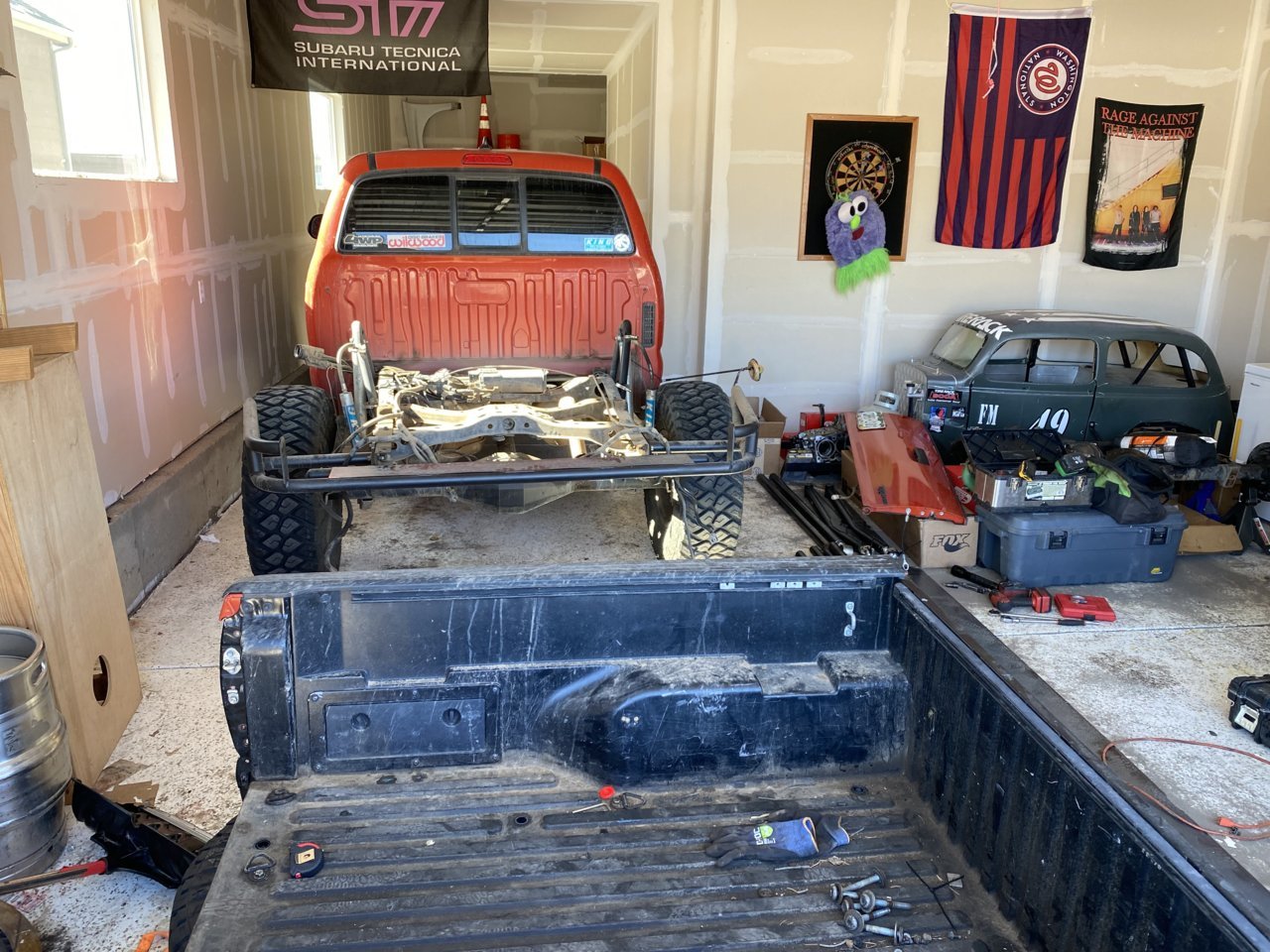

    Pulled the bed finally and got all my mounts welded and ready. Picked up all my metal this morning.

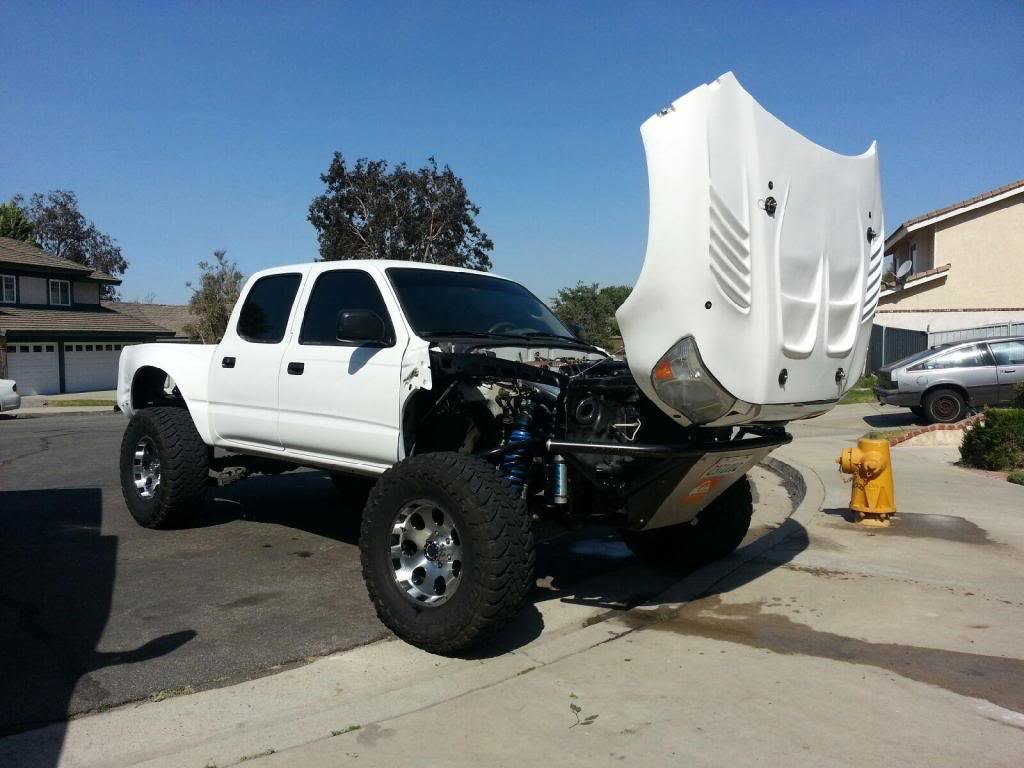

    Yeah 1 pieces typically are made for trucks that have been out awhile and are reaching the point where people are putting big suspension and racing on them. I believe that truck has a Quixotic front kit. FWIW most guys will build a front hinged sub frame for one pieces so the only thing that is really mounted to the "body" is the small mini-fender portion near the door or nothing and the whole thing rotates forwards.

    From pretty much everyone on here and elsewhere that I've heard talk about 4 hood pin hoods, they hate it and wish they had hinges still. For that reason I kept my hinges.

    https://www.tacomaworld.com/threads/02-double-cab-build.209588/page-25#post-6836381
    Basically just a bolt through a piece of tube with holes drilled in the plated ends. I'd try to reuse the factory hinges if they're bolt-on on 3rd gens like they are on 1st gens (and I assume 2nd gens).
