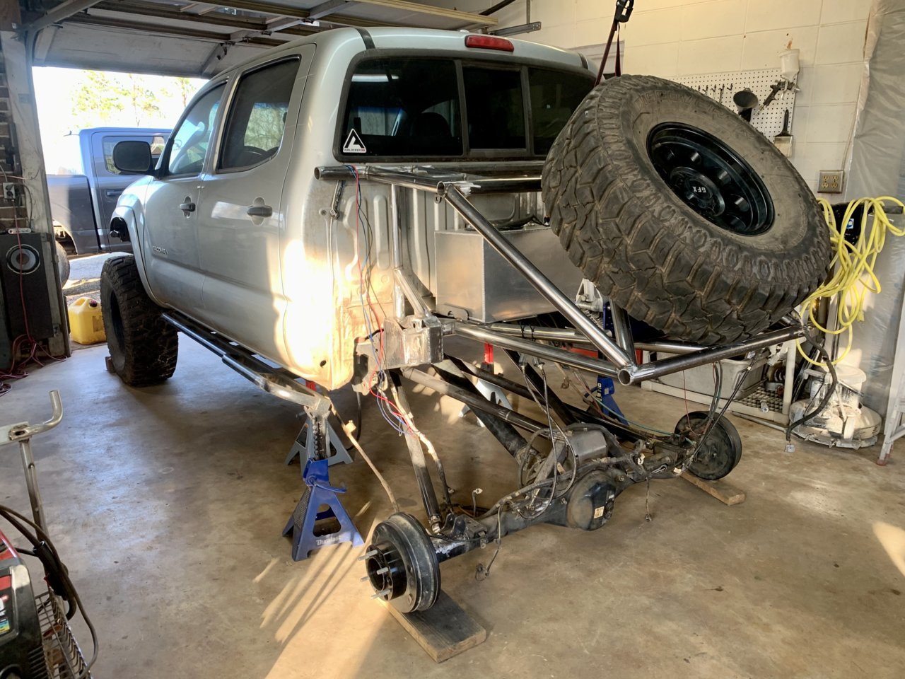

    Finally everything cycles without binding or bending. Now death by a thousand small details.

    Thanks man. I finally feel like I’m over the hill on it. Now just a million tiny projects left to do and we will see if it rolls out of the garage :D

    Does having balljoints in the UCAs really handle all that much better than uniballs?

    Someone correct me if I'm wrong but I believe ball joints are preferable in OEM style applications due to minimal maintenance and trouble-free longevity. Uniballs are preferable in race-style applications because they're stronger and have a smaller footprint but at the cost of increased maintenance due to not lasting nearly as long.
    As far as how that translates to handling one way or another, I don't know.

    Sounds about right to me. I’m the past uniballs had a greater range of motion but modern ball joints I think have closed that gap if not surpassed the range of motion of uniballs. The argument like you said is gonna be strength vs maintenance

    Sitting on its own weight. It’s about 2” too tall. Might settle and a bit more weight to add, but I think I’ll be swapping coils.

    Looking good! Is that area at the top of the coil threaded all the way up? Like could you pull the 2" out of it from there?

    It’s possible he’s at 0” of preload right now and if he backed that collar off that the springs would be loosey goosey at full extension. Obviously just a guess though.

    @EatSleepTacos is correct. That’s zero preload. On 125 and 150 coils. Seems so light based on IFS stuff haha

    I'd wait till its full fluids and loaded like you'd be to head out. May settle out.

    No doubt. Empty tank and still have some tube and stuff to add. Doesn’t take much to drop it.

    if your effective spring rate is 68lb/in, then hopefully it drops down to right where you want it once everything's is buttoned up!
