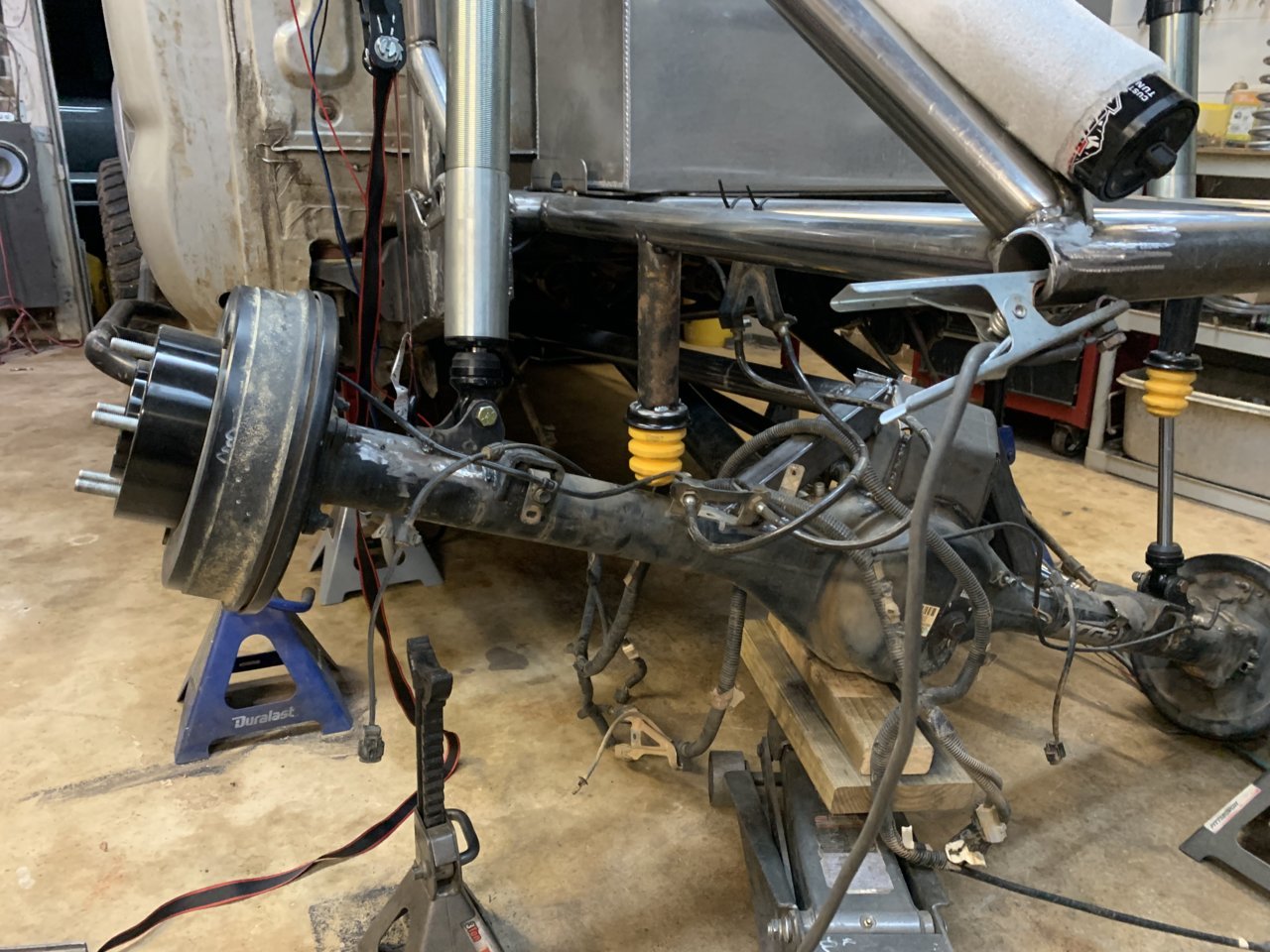

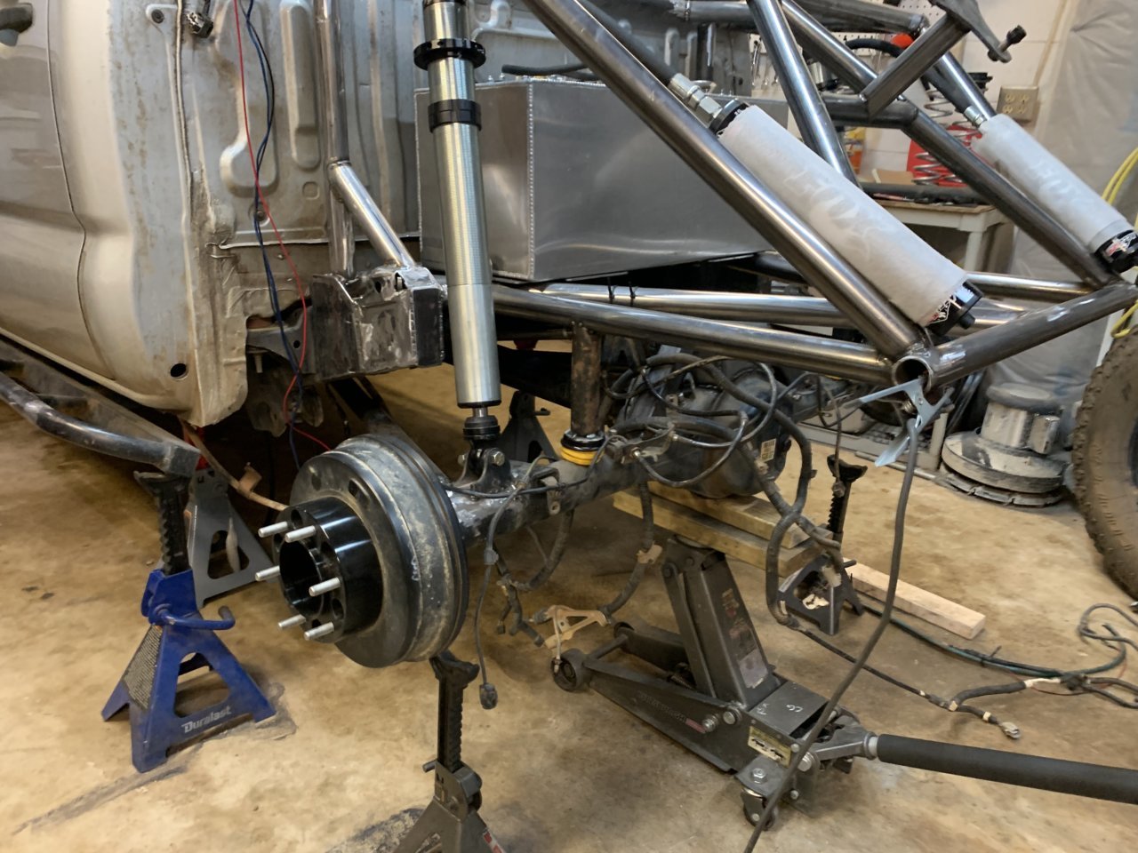

    @Tacoma1192 set up is similar. It's difficult (maybe close to impossible on our trucks except with prerunner trailing arm set ups?) To get the bump and CO to end at the exact same point on suspension travel and articulation. IIRC he was told by accutune that it would be OK. I think his hydro bump partially engages but doesn't bottom out on articulation. If you hit max articulation with enough energy to break something there's a good chance you're about to die or your truck is going to be totalled. IIRC even on my SOA set up the shock and bumps didn't land exactly at the same place and ended up protecting the shocks on articulation and gimped suspension travel a little to do it.
    On my own set up with my trailing arms, the axle mount so high on the axle I bottom out the shocks without ever engaging my hydrobump at full articulation. However, I will have 2 shocks supporting the weight and have the bump zone on the bypass to slow the speed at the end of travel.....along with a sway bar so I don't know how often I'll ever actually get to full articulation.
    If you were really worried about it you could get some IBP shocks from king or squeeze bypasses in.
    Only thing I would recommend would be a dedicated axle side bump strike pad and try to add some gusseting to the bump extension, there may be enough angular force on the bump during articulation to break it off at weld on the base. If there's no way to add strength I would just keep an eye on it and give it good periodic inspections.

    I mean you've seen the g-outs mine has taken no bumps no straps. The reverse slam on boat ramp put a slight bend in the shock shaft and it's still riding dirty. You can find longer rubber bumps that'll compress more or look to go outboard. The hardest part with these set ups for bumps is the amount of articulation requires a larger landing pad since at all the different ranges it'll hit in different spots especially with the further out you go. You can put the bump on the axle then make an angled plate for the frame that will allow different distances for the flex and be easier than locating a big pad on the axle.

    That’s kinda my thoughts. Those rubber bumps on the shocks are pretty tough, too. It may be the last house on the block so to speak, but they aren’t just there to look pretty and limit travel. Full tilt and trying to bump something is the hardest it’ll get. Probably going to flip if I bump something hard enough to break a shock. I’ll likely run it without bumps and thrash it here at the house to see how often I’m bottoming out. I rarely ran through the four inches of up travel I had before enough to be uncomfortable. If it rides like poo I’ll throw some bumps in. I’m sure I can figure a way to get it almost to the spring perch.

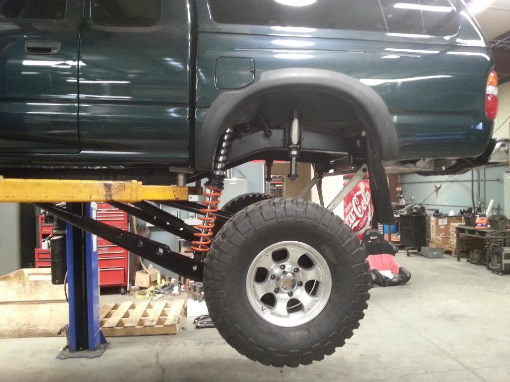

    Whose Truck is that? more pictures anywhere?
    I'm thinking I need to do a similar setup, packaging a 4 link and a decent exhaust without Axing the bed on a 1st gen dcsb is feeling near impossible to me.

    Brenthel trophy trucks and Kibbetech uses them on their billet links. Just search Gen 3 Brenthel trophy truck.

    I don't see what you mean at all lol.... they Package their exhaust in typical bed space to prioritize link placement.
